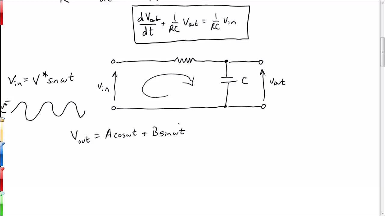

I understand the general working pinciple, it's just that the cut-off frequency term confuses me, especially for a PWM waveform. I found a youtube video, that explains as so. It basically takes an average of a given waveform.
It averages the 20% High, and the 80% Low, for instance.

P.S. Found a really good explanation video https://www.youtube.com/watch?v=WZN42JO_kFo
A few youtube videos later, and I think i'm starting to understand the theoretical operation.
