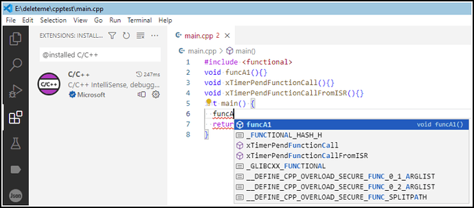

I'm afraid this fuzziness is standard language server behavior, not anything specific to Arduino. For example, here is the same clangd language server used in VS Code in a standard C++ program:
Here you see similar results when using Microsoft's C++ "intellisense" instead of clangd:
I think this fuzzy matching behavior is generally useful to experienced developers (i.e., we want matches even when we made a typo), but might be more confusing to beginners. This is why the "Editor Quick Suggestions" feature is disabled by default. With the "quick suggestions" disabled, you must manually trigger the suggest via the Ctrl+Space keyboard shortcut, so the potentially confusing information is only presented on demand.
