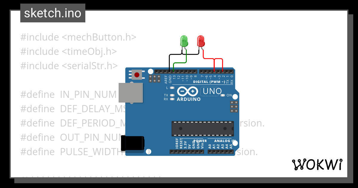

From what I understand this should do it..
I had to slow it down a bunch so you can see it working on the simulator.
But, if the whole point was to learn the fancy new processor, then this'll not be of any help.
