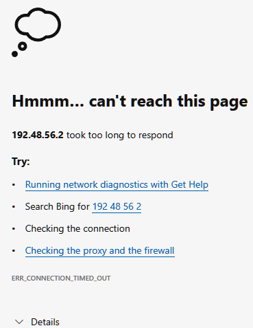

I cannot get the R4 Access Point example to work. Everything in the serial monitor looks okay, but when entering the AP IP address into the edge browser, it is not found.

When I enter http://192.48.56.2, in Windows Edge" I get:
The same thing happens if I change the IP address in the code with:
WiFi.config(IPAddress(192,168,1,101));
There are no other devices on my network with the address ending in .101;
The AP that is created is also CCECA-16670 which seems right.
I have tried turning off the firewall. I have also tried disconnecting my pc from the network and reconnecting to the CCECA-16670 network thinking it might be the AP this time, but that doesn't help either.

does the server example work if the Uno is connected to an access point?
Not sure because the UNO is the new access port.
This is where I am confused. I'm thinking the Uno creates an access point with the same name as my network, CCECA-16670. If that is what it is doing how does one connect to the AP with that name rather than my own home network with that name?
If the UNO is creating an AP with a different name, I'm not seeing that when I look for available networks.
Bottom line is I don't know what I should reconnect to once I disconnect my PC from my home network.

************************ Update ************* Update *************************
The Access Point example tells me it is creating an access port with the same name as my network.
Access Point Web Server
Creating access point named: CCECA-16670
SSID: CCECA-16670
IP Address: 192.48.56.2
To see this page in action, open a browser to http://192.48.56.2
Device disconnected from AP
Delta-G was right.
In the example Access Point at https://docs.arduino.cc/tutorials/uno-r4-wifi/wifi-examples the example called Access Point creates a new access point with the same name as the as the network you are signed into. That doesn't work,
I changed the line:
status = WiFi.beginAP(ssid, pass);
to
status = WiFi.beginAP("Arduino", pass);
That got the example working.
