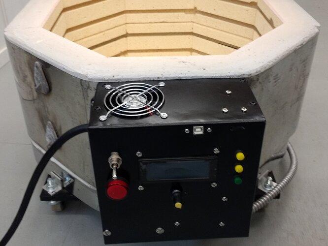

Hi all,
I am trying to implement a ramp/soak controller based on a resistive element as the heater and a type-k thermocouple as the temperature monitor.
So I want to be able to ramp from ambient to 200C, then hold for 100 seconds.
Then ramp to 400C and hold for 100 seconds.
Then ramp to 600C and hold for 100 seconds.

Thanks. I am building a PLA burnout furnace for aluminium casting so the ramp parts are just the heating element "full-on". Its the setpoints at 200, 400 and 600 which will be under PID control.
When I try to compile, I get an error for these two lines:
Setpoint = (array*);*
setTime = (array[j]);
error: cannot convert 'int [3]' to 'double' in assignment Setpoint = (array*)*
error: invalid conversion from 'int*' to 'int' [-fpermissive] setTime = (array[j])
Setpoint is double type, setTime is an integer.
Your declaration for "array" is in some way wrong but since you didn't post your code, only you can see it.
Please read the How to use this forum and post your code as described in topic #7.

Ok...
for (i = 0; i < ROW_DIM; i++) {
				for (j = 0; j < COL_DIM; j++) {
					Setpoint = (array[i]);
					Serial.println(array[i]);
					Serial.println(array[j]);
'Where is your declaration of Setpoint and setTime?
DrDiettrich:
Sorry, I don't mean for this to be like dragging teeth for you gurus.
/*PID working variables*/
double Setpoint, Input, Output;
//not a PID var
int setTime = 0; //initial on time

I just joined. Have been trying to get a kiln controller going for some time.
negativ3. what sort of mold material are you using? i run a foundry and your burnout cycle doesn't make sense to me. when i use ceramic shall molds its an aggressive burnout because the mods handle the shock well. room temp. to 700c as fast as possibly. hod for an hour and cast hot as possibly.
on investment the molds are fragile. ramp at 200c/hr max. firs soak at 200c for several hours depending on the mold diameter. then 200c/hr up to 700 and soak for long .min 5 to 6hrs. then bring down to 500c and soak for one hr to stabilize casting temp through the mod.
I dont beleave that pid is that important. small enough increments temp raise and small steps hold before next increment will work. a kiln has huge thermal mass. so every thing happens slow.
if you heat for 5 sec it takes the thermocouple on my kiln 10 to 15 sec to register.
ill post update on my build soon. going to see a friend this weekend who knows his way about code to help me resolve the "grammer"of my code.....
Hi. i just got this build done in prototype form and it works well.
i used a nano and 20 x4 i2c lcd. max 6675. and a home made ssr(to be upgraded) cheap micro sd card reader and a good quality micro sd card.
powered a soldering iron as heat source to test.
