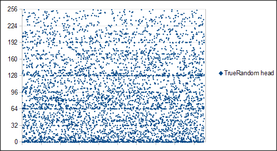

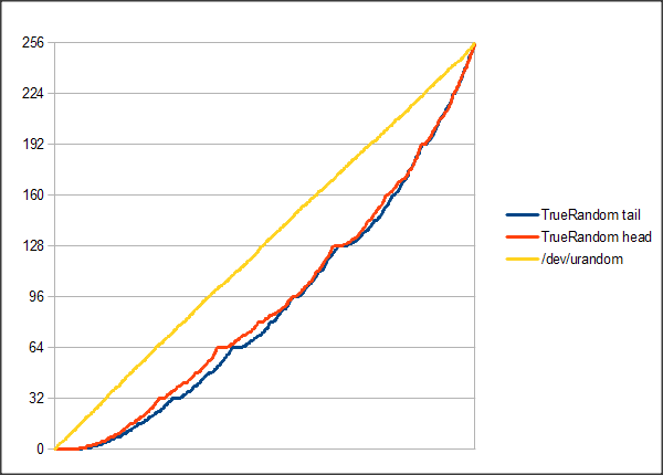

What do you consider to be the flaws? I think it's a flaw to throw away all the bits except the last one, since the others could have randomness, too. And it's a flaw to sample a floating pin, since the signal on that pin varies wildly from one circuit and environment to the next. It could be held to ground by parasitics and the ADC would output nothing but 0s.
I tried testing TrueRandom on my Duemilanove and it does not look "truly random".
~> ent TrueRandom.bin
Entropy = 7.544390 bits per byte.
Optimum compression would reduce the size
of this 92810048 byte file by 5 percent.
Chi square distribution for 92810048 samples is 131287892.21, and randomly
would exceed this value 0.01 percent of the times.
Arithmetic mean value of data bytes is 93.7178 (127.5 = random).
Monte Carlo value for Pi is 3.682216212 (error 17.21 percent).
Serial correlation coefficient is -0.008583 (totally uncorrelated = 0.0).
which is "almost certainly not random". The numbers it gives are clumped around 0 and powers of 2, which I think just means it spits out lots of 0s and few 1s.
I'm confused. You state it's a flaw to throw away all but the last bit but then prove even the last bit is not random.
