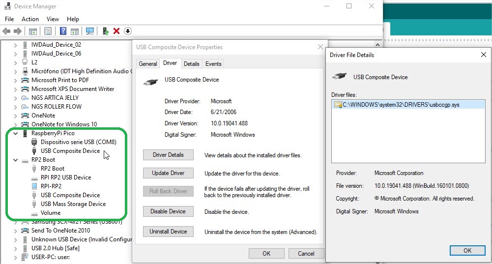

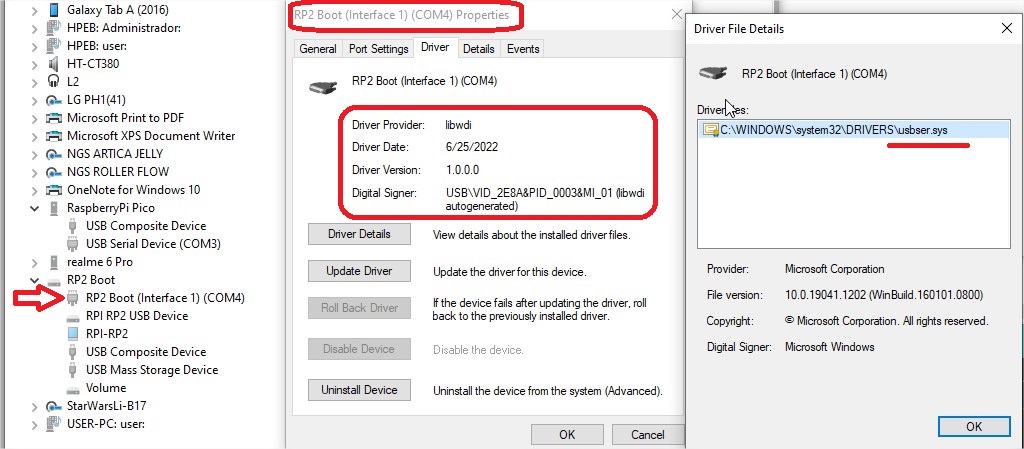

I found that the drivers loaded on both PCs are different
 ![RP2 Boot Working Driver](https://europe1.discourse-cdn.com/arduino/original/4X/2/e/0/2e081c92ba12743fe0f30ea7f7958b32bd679b8c.jpeg)
This is the Driver loaded by the Working PC
 ![RP2 Boot Not Working](https://europe1.discourse-cdn.com/arduino/original/4X/5/2/c/52c089d6d85b41f688592c9420f7af6cc2bb4a47.jpeg)
and this other is the one loaded on the PC that doesn't' load the sketch
I think there is the problem, but I don't know how to fix it
