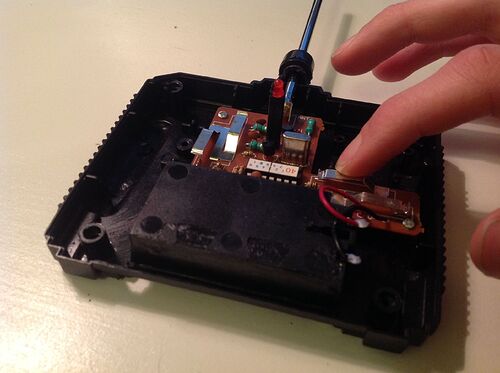

I am new to this forum and quite new to arduino too. I am from Sweden so apologise for my english.
I am thinking about controlling a rc car toy with my arduino. I know that it is not a new idea. When I have taken the controller apart it looks like this:
I think i works like this:
When the metal plate I point on is pressed down, it will allow current to pass through to the sending equipment. Now comes my question:
Can I connect the metal plate and the other metal part underneath with a transistor(BC547B) and connect the base to the arduino?
If I connect all four metal plates to their corresponding metal part underneath with a transistor will I be able to control the car from the arduino?

I don't know if a transistor would work or not. You'd need to have the Arduino and the transmitter share a common ground connection in order for this technique to work.
I think a more reliable technique would be to use four relays. The relays could be controlled with an Arduino (make sure you use the correct circuit (including transistor and diode)). This would let you control the car from the Arduino.

What are the various voltage levels of the pieces of metal?
I wonder if you could pull a piece of metal low or set a piece of metal high to control it?
If we knew what the voltage levels were, we may be able to come up with some other suggestions.
Do you mean physically moving the metal plate up and down? That is what happends when it is working as it should.
Kalle20:
I'm sporry, but I don't know what the voltage levels are.
Do you have a volt meter?
Kalle20:
No. By "pull down" I mean connect the metal to ground (0V). "Pull-up" would mean connecting the metal to 5V (in the case of an Arduino).
A resistor would like be used when pulling the metal high or low to prevent damaging the Arduino.

Many if not most of these toy vehicles use a chipset known as the TX2/RX2 chipset - it is a very common toy RC car chipset used by chinese toy manufacturers. I bet if you peeled up the sticker on that 14 pin IC in the controller, you would find writing on it that would indicate its in the family (or is a clone).
Once you know that - and you have the data sheets for the chipset in hand, it should be fairly straightforward to hack the car directly.
See this "mega-thread" for a ton more details - I always link to it when discussion of this kind pop up (I still don't understand why nobody seems to find it on their own, though):
http://forum.arduino.cc/index.php/topic,86883.0.html
Basically - yes it is possible to get the h-bridges under the control of an Arduino - the point of using the datasheets is to be able to identify which pins of the RX2 chip on the receiver board are for the motor driver outputs. Once you know that (and the voltage being used for control) - its a simple matter to have the Arduino apply the signals instead (after cutting out or removing the chip - this must be done).
If you look toward the end of that thread, though, you'll find links to other threads that are interesting; one in particular was experimentation done to emulate (using the Arduino) the radio signal of the TX2, and feeding that into the RX2 antenna input. That way, you only have to worry about one wire (you need to isolate that pin, though, from the existing RC receiver circuitry). What you give up, though, is fine control - you'd only be able to control the car as well as the original transmitter - which on these cheap cars isn't much.
Honestly - given the low cost of Chinese made h-bridges on Ebay and elsewhere, stripping the RC receiver from the car, and adding h-bridges to control the motor and steering actuator is probably the easiest and best way to get the car under control of the Arduino. If you can remove the steering motor, and replace it with a standard RC servo - you'll have fine control over the steering (using the Servo library), too (and you'll only need a single h-bridge). You could also go one step further and get a low-cost Chinese hobby RC ESC (electronic speed control) for a brushed motor - then you could control it with the Servo library as well.

That's basically it! But there is one final interesting bit about your car - look at the final image in the album I posted.
Here, we can see your two motors which drive the car and control steering (1 & 2) - but the interesting part is in the areas marked 3 & 4: Your car has encoders (ack - I just noticed in the picture that the front wheels also have encoders)! For some purpose these encoders (which likely output a pulse for each quarter or so revolution of each wheel) are connected (it appears) to that smaller secondary PCB; while there isn't enough to go on from the image - my best guess is that they were used for sound effects or something else of that nature, since they don't seem to have connections to the main receiver PCB.
You could use these encoders yourself in the car, once you figured out how they work - but that would take some more hacking (and I can't help you there - because there isn't enough information in the pictures or otherwise to know how they work - they might be hall-effect sensor, they might be optical, or they might be magnetic switches. Since this car is so cheaply made - I would bet on the last option - that they are just simple switches activated by magnets on the wheel disc (easy enough to check - see if a small screwdriver sticks to the magnets). If that is the case, then they would be dead simple to hook up to the Arduino. What could you use them for? Well - monitor the speed of the vehicle, and pulse the drive motor to keep the speed constant. Or, use them to monitor for slipping wheels (aka - ABS brakes?). Or - just monitor them to know how far you have traveled (a simple means of dead-reckoning control).
Finally you ask:
Kalle20:
The problem is that i dont know what voltage and current the motor needs and i can't find any name or any information on the motor. Is there a way to find out?
Well - the simple way is to look at the battery compartment - it looks like the car takes AA cells - probably 4 of them? If so - you are looking at 4.8 to 6 volts (depending on the battery chemistry). Which is inline with what the RX2 needs. These motors are very simple, and likely don't need more than 6 volts and only a few hundred milliamps of current to drive them. Note that the h-bridges on the RX PCB are made of small signal transistors, which likely can only carry 200-500 milliamps (though they could be mosfets - but I really doubt it). If your h-bridge is an L298 or L293 (which are actually packages with 2 h-bridges - perfect for this application), it should have no problem powering this car; just remember, though, that those h-bridges are bipolar transistor h-bridges, and as such, drop about 2 volts - so you might need a slightly larger battery to compensate.
I hope this all helps you or someone else - it was fun writing it, and I am going to link this thread back over to the mega-thread so that others can find it from there...
Good luck with your project.
:smiley:
cr0sh:
(continued from previous):
Thank you for your posts. They are very good and explaning and I hope that i will have use for them too. :slight_smile:
Of course you can use the pictures.
There are LEDs in the wheels, so i don't think there are any encoders there.
Can i do the things you described in your posts without soldering? I don't have a soldering iron.
cr0sh:
If it were running off of 4.8 - 6 volts (common, if there are four batteries in the battery compartment), then you could likely run the lines direct to the Arduino pins, maybe with a 220 ohm current limiting resistor in series (mainly to protect the Arduino from excess current draw).
The car has 6 batteries.
cr0sh:
If the voltage is less, you'll want to reduce the logic level HIGH the Arduino uses (5 volts) to that lower voltage, using a voltage divider or other means. To find out what voltage the RX2 is using, just measure it at the chip between pins 2 and 13 using a multimeter.
I can't measure the voltage, because i don't have a multimeter. Is there another way around?
cr0sh:
I tested to see if a magnet sticks to the wheels and it does. Can it be both LEDs and encoders inside the wheels?
cr0sh:
If you were going to use this board as-is, what you would do is take the images, and make a bunch of notes - both written, and probably on one or more copies of the image itself. You would want to note which pins (bottom and top) of the IC did what (so you knew where to solder wires for the Arduino or whatever), and you would want to make note of connections to the other major sections. Then, you would carefully de-solder the RX2 IC - doing your best to cleanly separate the chip from the board (without lifting any traces). You would also want to disconnect the power to the RF receiver block (by either disconnecting all ground points or all positive voltage points - whichever is easier). This can be done by either desoldering the components or jumpers to those points, or by using an x-acto razor knife to cut through the traces (basically introducing a "break" in the circuit). You would want to take care, though, not to remove power to the h-bridges, obviously.
Can i do this stuff without solering, because i don't have a solering iron? Or is there another way to use the board as it is?
Kalle20:
Then it is likely either 7.2 volts (6 x 1.2 volt NiMH or NiCd cells) or 9 volts (6 x 1.5 volt alkaline cells); it will probably run fine on either, but I would start with the lower voltage first.
Kalle20:
It would be best if you purchased or otherwise obtained a multimeter - it is the minimum basic test equipment you need for electronics work. A low cost one should be able to be found for around $5.00 USD.
Kalle20:
Hmm - if they are LEDs, then that would explain why they didn't appear to connect to anything on the "main" board, and instead connected to an auxiliary board. I now suspect that there aren't any encoders, and you should ignore anything I proposed regarding such (unless you want to add your own). Still - lights could be fun to play with, and they could help with testing, too. So don't get rid of them completely. But you may want to disconnect them from the smaller board, just keep them connected otherwise, so you can use the Arduino (with probably a series resistor) to control them.
Kalle20:
If you plan on using the board, or "hacking" the TX2/RX2 chipset - then you will need a soldering iron, and know how to use it, too. There isn't any getting around this.
Otherwise - you would need to find yourself a couple of h-bridge modules (they are available relatively inexpensively) to control the motors, and then clip the motor leads from the board, strip then ends, and put them in the screw-terminal blocks that are on many of these modules. The Arduino could be connected in a similar way, using jumper wires or similar.
But before you can purchase an h-bridge, you need to figure out the specs (mainly voltage and current needs) of the drive motor and steering motor/actuator. Without those numbers, you can't properly purchase the right h-bridge to match.
Thank you so much @cr0sh for the detailed explanation. It was really helpful to me. I am working on my son RC car which has same chip. However, my project is to add indicators and other leds to match car operations. for e.g. turning on right indicator when car turn right. If i understood your guide right i should take PWM (PPM) measurement from pin 5 on the receiver and program arduino to trigger events accordingly, am i right? if not please guide me to which pin i should attached my arduino to RX-2B receiver to take PWM for all operation?
Thanks in advance.
