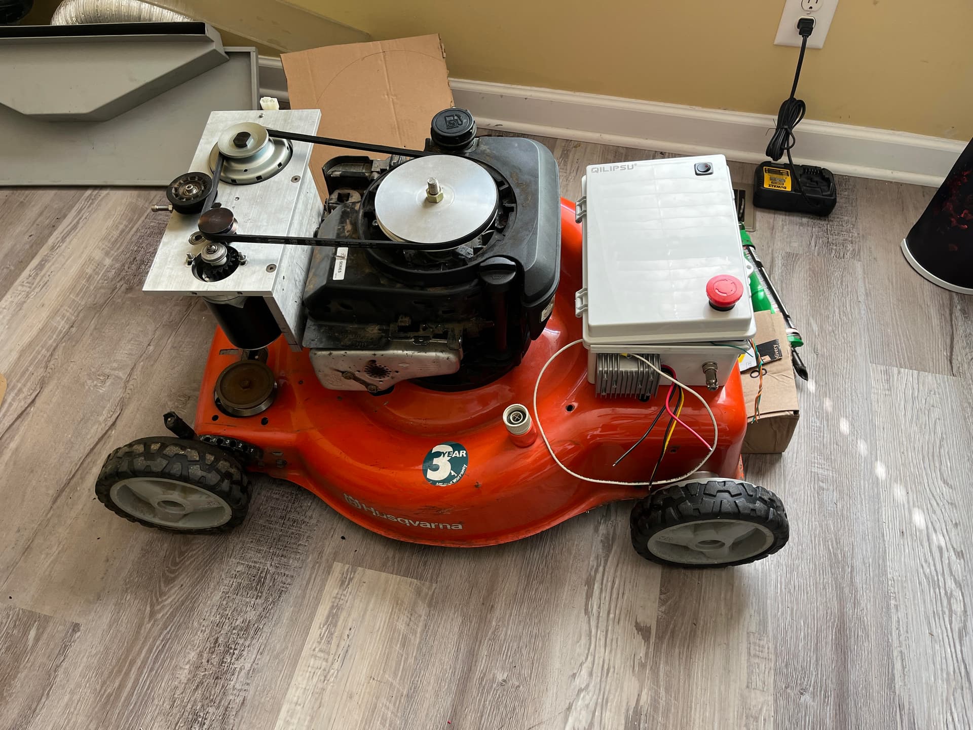

RC Controller to UNO, need some guidence
Hey Folks!
I need some help completing this code I found from Andy Vikers YawTube, converting RC signals to usable data in my uno. My scope of c coding is not good enough to figure out how to extract the arrays from his code and control my motors.
I've a L298n pushing two dc gear motors, and I need help sending pwm to pins 5,6,
then on/off for the directions, in1, in2, in3, in4.
Here's what I have so far:
Thanks!!

// Setup our program
//here ive defined my pins......................................................................
pinMode(enA, OUTPUT); //SET PINS OUTPUTS FOR L298N DRIVER INPUTS
pinMode(in1, OUTPUT);
pinMode(in2, OUTPUT);
pinMode(enB, OUTPUT);
pinMode(in3, OUTPUT);
pinMode(in4, OUTPUT);
Channel 1 = RC_TRANSLATED_VALUES[0]
Channel 2 = RC_TRANSLATED_VALUES[2]
Channel 2 = RC_TRANSLATED_VALUES[3]

// here is what I've added so far, not sure what I'm doing wrong........................................
Channel 2 = RC_TRANSLATED_VALUES[1]
Channel 3 = RC_TRANSLATED_VALUES[2]
if(RC_TRANSLATED_VALUES[0] > 1520) {
  analogWrite(enA,200);
 digitalWrite(in1,HIGH);
 digitalWrite(in2,LOW);
} else{
  digitalWrite(in1,LOW);
  digitalWrite(in2,HIGH);

This a for a lawn mower, ha, I know. I've a large yard and not money for a zero turn, and I thought this would be a fun project. I'm almost there! I just need to figure out this code. Ultimately I might want to use gps and program it for the large sections, but I just need to get it moving first.
I'll have to figure out how to slow and reverse the rear wheels to turn, but I'm hoping I can figure that out with the 'if' command.
I'll need a few more channels, at least for starting the engine, and stop, maybe program mode and run program, but I might do this from the box and not remote.

How do you plan to zero-turn (differential (skid) steer) that mower? When that turns, the undriven wheels will skip-skate without at least Ackermann steering (which obviously isn't zero turn anymore), won't it?
There are plenty of folks who have done this project. I have not. I have made heavier "robots" (200 plus pounds) but I use hobby RC aircraft TX/RX to control those and the channel mixing is done "in house" on the Spektrum transmitter settings itself.
If you are planning on remote starting this gasoline engine and anything else, you might as well get a multichannel RC aircraft TX/RX and call it a day for now. That's how the BattleBots folks seem to do it, that's how lots of guides do it and that's what the Youtuber you're following was showing.

Is that a motor controller on the end of the Gilipsu project box with the red, yellow and black wires coming out?
Thanks for the response 31'.
That is a rectifier, I'm planning on using the engine to drive an alternator, giving me on board power.
I'm planning on having the steering by slowing one of the wheels, an perhaps floating the front wheels for sharper turns.
