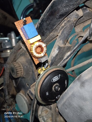

Wire was shiI used an X2 capacitor and an inductor in a C-L-C method to reduce EMI. I also used multiple X2 capacitors in the circuit near the DC-DC isolator. First, I applied a C-L-C filter near the horn, and the second C-L-C was used in the circuit. This setup works perfectly fine if I don't connect the RC522 directly to the bike. I supply the horn and Arduino circuit with isolation from another battery, and when the horn blows, it doesn't affect the RC522. The problem only occurs when I connect it to the bike.

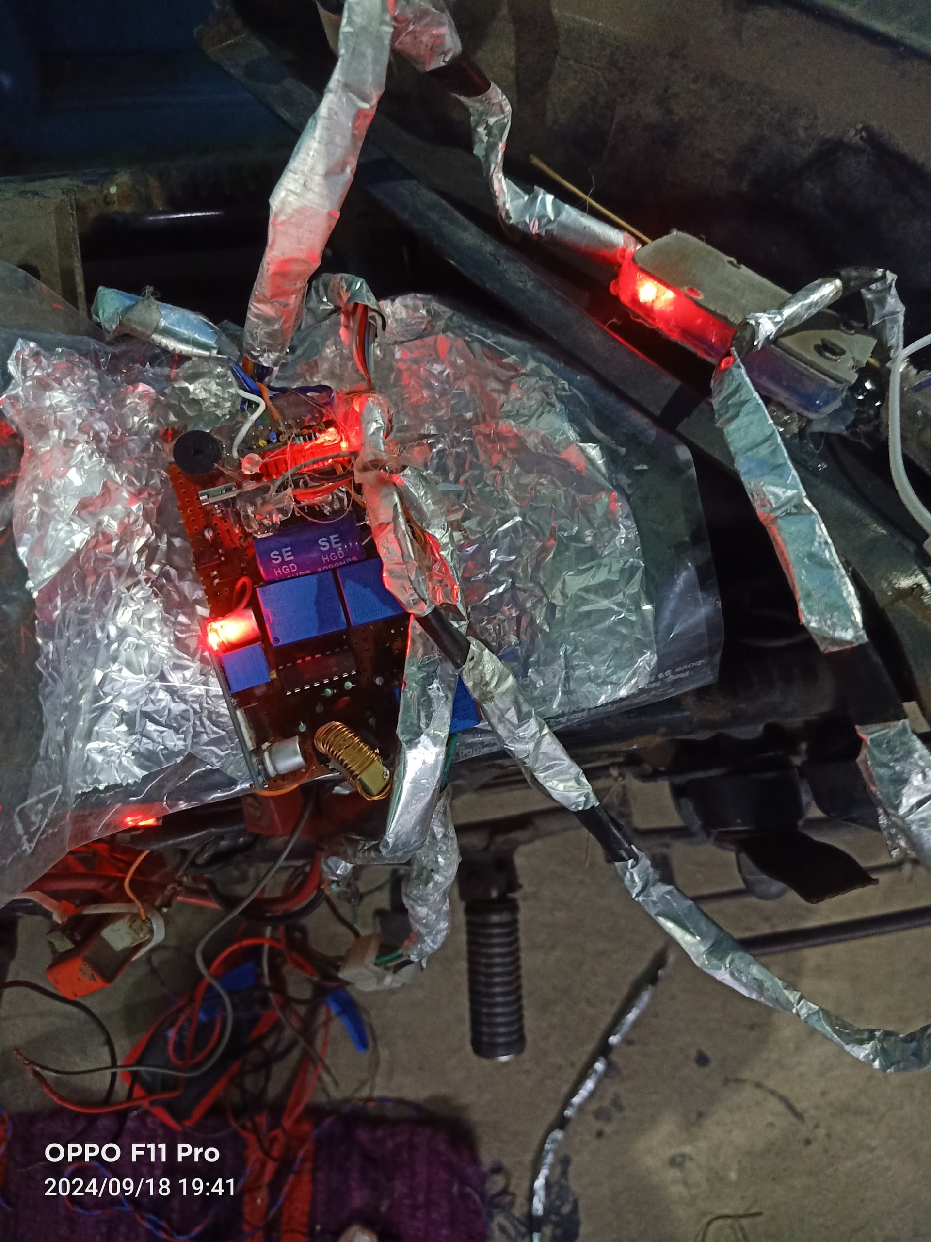

I used aluminum foil to shield the wire, but I didn't common shielded cable's shield. Instead, I applied shielding for each sensor's wire from end to end, but I haven't placed the Arduino circuit in a metal case. I also used an optocoupler and a DC-DC isolator, but the EMI doesn't affect the other sensors—only the RC522. Last night, I watched a YouTube video where the YouTuber's RC522 worked even after the bike was started.
I didn't connect the shield to the bike's chassis.
Then it was not a shield.
"Sir, if I use double shielding, and the outer shielding is connected to the bike body, will that be effective?"
If what you show in the picture is your idea of shielded wire, then no, that will be of no help. Use REAL shielded wire. Wire made with a braided wire over the inner wire insulation. Connect one end of the braided wire to the bike frame.
Making a solid electrical connection to aluminum foil is nearly impossible because of the oxide coating of the aluminum.
And put your Arduino and all other components inside a metal box and the box firmly connected to the bike frame
