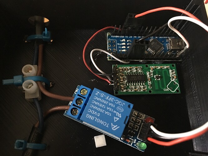

Pretty new to Arduino but I managed to construct an RCWL-0516 and 5v relay circuit to switch on a light but am having some problems.
The sensor activates the relay and about 50% of the time it switches itself off again after 3 seconds of not seeing any movement. The other 50% of the time, it switches off then immediately switches back on again. It'll do this a number of times then switch off and stay off, until motion is sensed again. It's almost as if the RCW is storing movement info and sending it to the arduino as soon as the 3 second delay is over.
Is there anything I can do to my sketch to make the relay behave like I want?

I used:
RCWL-0516
Arduino Nano
5v relay
Thanks in advance for any insight.

The RCWL-0516 detects tiny changes in it's radar wave field. Switching on and off a relay inside it's detection range probably causes such changes. You either have to shield the two parts very effectively or add some time after switching the relay during that no sensor input is used. The easiest way to achieve that (but quite bad code) is to add a delay(3000) after switching the relay off.

Thanks for the reply. Code tags inserted and delay(3000) added to sketch. Fingers crossed.
