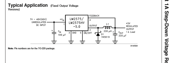

i started to look at the LM2575T-5.0, think this would solve my 5v problem.
im confused as to how to supply the ic, can you only supply it from the - and + from a bride rectifier, as it states in the data sheet unregulated dc input 7/40v input.
or can you supply it by using a regulated +v be great if i could supply it using using a regulated +v out of my 7815.
thank you
You gain little benefit from feeding the LM2575 from the 15V regulated supply since the switching regulator is much more efficient than the LM7815. Why would you want to have the 7815 linear regulator also be responsible all the current used by the 5V power source? It will most likely need to have a heatsink as a result. You might be able to get away with not having a heatsink on the 15V regulators at all if you attach the Input side of the LM2575 to the unregulated leg of the + side of the bridge.

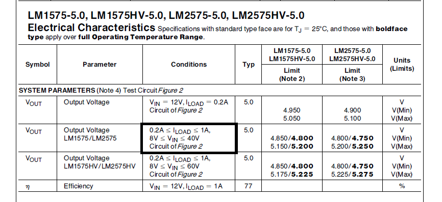

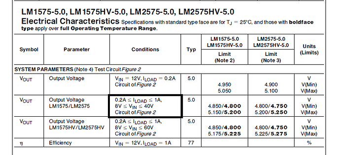

can somebody please explain the data in the highlighted box please,
does that mean voltage has to be 8 to 40v input, to output those min max voltages? (and use fixed point grounding)
really dont understand this, 0.2A < ILOAD < 1A, what does the symbol like this mean <
Some switching regulator solutions require a minimum "load" for the regulator to perform as expected. As well, it appears that they are clarifying the "drop out" point for a 5V supply is 8V. They are basically saying that nominal Drop out voltage is 2V... (sort of high for a regulator)
0.2a < load < 1.0a means that the current pulled by the load is somewhere between 0.2a and 1.0a. (0.2a is less than the load which is less than 1.0a.) So they're saying the output voltage will stay within regulation (between 4.8 and 5.2v) as long as the load is between 200 and 1000mA. Before settling on this regulator, I would want to know what the absolute minimum supported load is, since a micro alone pulls very little power. I'm assuming you're only going to be drawing 240mA part of the time...?

One thing that's not indicated on the diagram in reply #5 is that considerations about
the actual layout, component positioning, trace lengths and widths, ground planes, etc,
are extremely critical in getting such ckts to work properly.
Research this before proceeding.

ok thanks i understand now,
well the current does fluctuate a bit on for 20 seconds 90ma then circuit then switches on the 2 relays then 240ma, ive reciently added a bit more to the circuit so its probably running at over 300ma all the time, but there could be a situation where its only the 90ma.
so its possible the circuit is idle @ 90ma, thought maby of adding a dummy load to keep the current over the 200ma maby when idle say a 45 ohm 1w resistor or near, do you think this is a good idea?
using this LM2575T really does sort my problem with my power supply, cant think of another way round it

I would also round up a few more datasheets on buck and boost converters and look at
their layout suggestions too. If not done perfectly well, the thing will generate more EMI
than you know what to do with.
You may not need to burn that much power in a dummy load. Does the data sheet specify a minimum load to maintain tolerance? It could be that it just requires 200mA to be wtihin +/- 0.2v, but you don't necessarily need it to be THAT tight.
oric_dan -- Any suggestions on how you would know? I built my first switcher recently. I have no idea how to measure for EMF, or any other metric to determine if my layout is any good. The suggestions I've seen in some TI and Maxim datasheets are all rather sparse and tend to rely on the designer to know a thing or two already. "Ensure your layout uses best practices" and stuff like that. I certainly don't have any windy twisty traces, but if they need to be aligned to the phase of the moon, that went right over my head.
SirNickity:
You may not need to burn that much power in a dummy load. Does the data sheet specify a minimum load to maintain tolerance? It could be that it just requires 200mA to be wtihin +/- 0.2v, but you don't necessarily need it to be THAT tight.oric_dan -- Any suggestions on how you would know? I built my first switcher recently. I have no idea how to measure for EMF, or any other metric to determine if my layout is any good. The suggestions I've seen in some TI and Maxim datasheets are all rather sparse and tend to rely on the designer to know a thing or two already. "Ensure your layout uses best practices" and stuff like that. I certainly don't have any windy twisty traces, but if they need to be aligned to the phase of the moon, that went right over my head.
yes i suppose the only way is to build the circuit first and see what voltage tolerance i get out of it al loads under the 200ma, i soppose it doesnt have to be exactly 5v as a 328 do work down to 3.3v, i will report back with my findings.

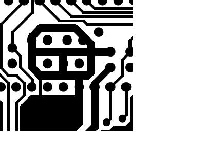

hi dan any chance you could show me an example of you ground island please
thanks
This is from one of my pcbs. Normally, the ground island is a little more symmetrical
but this layout was cramped. 2 caps go above and crystal below. Traces connecting
the parts is on the other side of the pcb.
