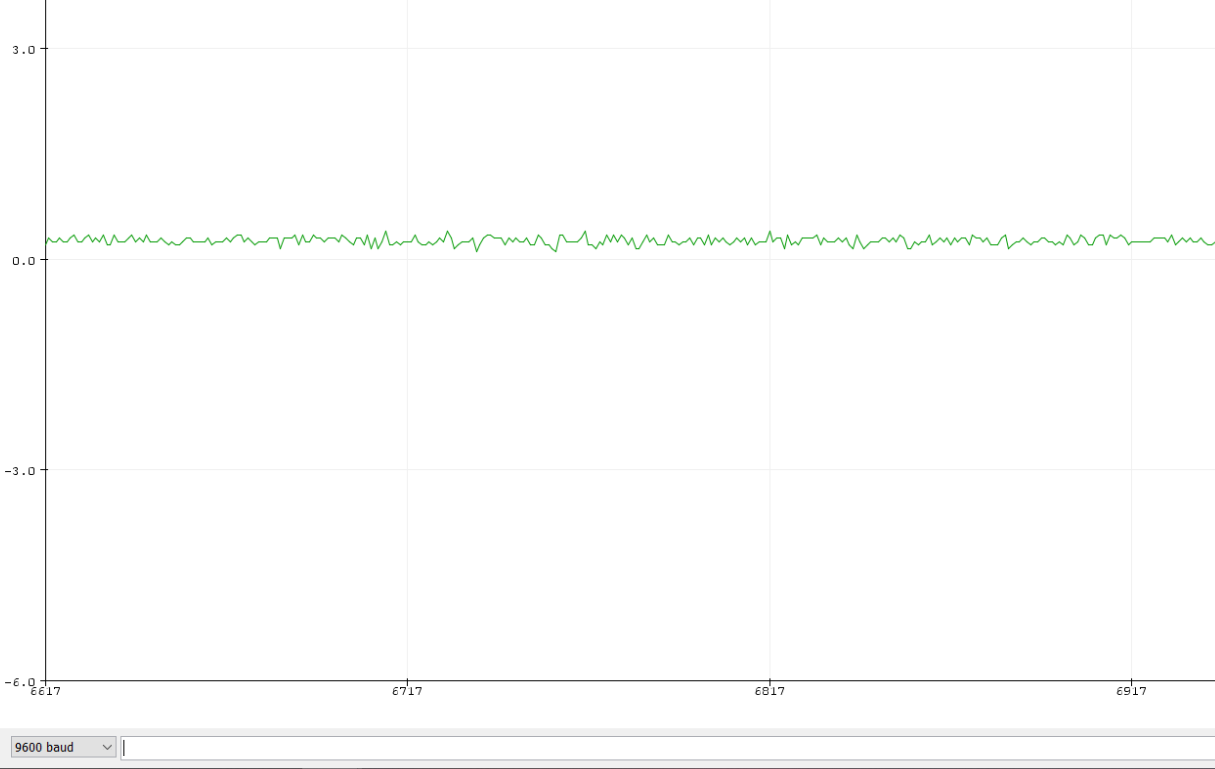

Hello, I have some problems with the sensor that I am using. The sensor that I am using you can find here. I use the 20A version. The problem I'm having is that the output of the sensor very chaotic is. At first, I thought it is because I'm using PWM to control a MOSFET that's connected to a power supply.
The frequency of the PWM did have some influence on it. for example:
pin9 (uno) 3.9k Hrtz and
pin6 (uno) 7.8k Hrtz.
And came here to ask if you would have an Idea to make the output more stable.

Try a low-pass filter before feeding it to the MOSFET. The cutoff frequency should be about an octave less than the PWM frequency.
