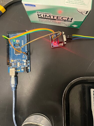

I found an old Mettler Toledo scale which has better documentation online, so I decided to use that. Would any issues arise with the 8 bit output with 1 stop bit, or would the arduino be able to understand it.
Here is my current wiring:
 ![IMG_2208](https://europe1.discourse-cdn.com/arduino/original/4X/2/7/a/27a8057f6227a256edf56039cc93c2467fb30275.jpeg)
(operation Manual: (page 51 is what I used)

I have just updated a setting on the scale to turn handshake to off. I am now getting a reading on the Arduino output that gives the correct weight of the scale for a second, but after this it outputs an infinite stream of question marks and gibberish.
Here is the latest output of the code.
RS232 - loopback connect 9-pin D-type pin 2 Tx to pin 3 Rx
S D 1339.4 g
TX1 to TTL/RS232 Tx and pin 19 RX1 to TTL/RS232 Rx
S D 1339.4 g
⸮⸮d⸮⸮kC0⸮T,⸮⸮⸮⸮⸮⸮⸮⸮⸮⸮⸮⸮⸮⸮⸮⸮⸮⸮⸮⸮⸮⸮⸮⸮⸮⸮⸮⸮⸮⸮⸮⸮⸮⸮⸮⸮⸮⸮⸮⸮⸮⸮⸮⸮⸮⸮⸮⸮⸮⸮⸮⸮⸮⸮⸮⸮⸮⸮⸮⸮⸮⸮⸮⸮⸮⸮⸮⸮⸮⸮⸮⸮⸮⸮⸮⸮⸮⸮⸮⸮⸮⸮⸮⸮⸮⸮⸮⸮⸮⸮⸮⸮⸮.........
I have spared you by not including every single question mark. lol
Any ideas as to what could be causing this infinite stream of characters?

<div class="post-metadata">
**Author:** ![d\_may123](https://avatars.discourse-cdn.com/v4/letter/d/46a35a/32.png) [@d\_may123](https://forum.arduino.cc/u/d_may123)\
**Post date:** [June 11, 2024, 6:52pm UTC](https://forum.arduino.cc/t/read-data-from-rs232-output-using-arduino-support-package-on-matlab/1269161/13 "2024-06-11T18:52:07Z")
</div>
IT IS DONE!!!
Fo anyone wanting to do this, here is the MATLAB code (I am aware this is an arduino forum, but an arduino is used). It most definitely is not optimized or perfect, but with some tinkering you probably could get it to fit.
