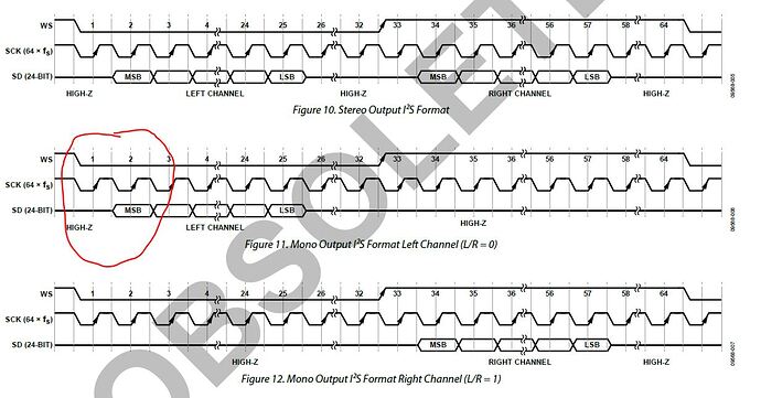

i have begun with arduino programming a few weeks ago and last few days i am struggling with SPI.
I am trying to read data from digital microphone ADMP441 (24 bits
via SPI with my arduino.
I sniff communication (look at att jpeg) and it look like that data are generated but i am not able to read them and check them e.g. via serial [ Serial.println(in); ] i get value 0 all the time.
this is my code:

I don't think you are communicating with that IC correctly. Here is the online datasheet:
Take a look at page 9. The communication requires 64 bits (8 bytes). The first 4 bytes are for the left channel, and the second 4 bytes are for the right channel, depending on the state of the WS line. The WS line is not the CS line. It should be a separate line. The CS line is not connected to the IC, only the WS line. The WS line should be LOW for the first 4 bytes and HIGH for the second 4 bytes.
edit: And how the IC responds depends on the state of the L/R line. If the L/R line is LOW, it responds during the WS line LOW (first 4 bytes), and if it is HIGH, it responds during the WS line HIGH (second 4 bytes).
If the slaveSelectPin (D10) is connected to the WS line of the IC, I would try this:
  digitalWrite(slaveSelectPin,LOW);
  delayMicroseconds(1);
  byte LeftOne = SPI.transfer(255);
  byte LeftTwo = SPI.transfer(255);
  byte LeftThree = SPI.transfer(255);
  byte LeftFour = SPI.transfer(255);
  digitalWrite(slaveSelectPin,HIGH);
  byte RightOne = SPI.transfer(255);
  byte RightTwo = SPI.transfer(255);
  byte RightThree = SPI.transfer(255);
  byte RightFour = SPI.transfer(255);

edit: The max frequency in the datasheet for SCK is 3.2MHz. You are trying 4MHz. That is too fast.
Hi SurferTim
yeah u r right with clock.
but how to solve the issue, that MSB bit is during 2nd clock period after WS goes log.1 -> log. 0 :~
Does the SCK pin still work as GPIO when in SPI mode? If so you could toggle it once yourself with a couple of digitalWrites().
Rob
I did not notice the SPI mode was incorrect. You should use mode 3. Clock HIGH and pulsed LOW, capturing data on the rising edge.
   SPI.setDataMode(SPI_MODE3);
edit: It may still be OK with MODE0 according to the timing. Print the values returned from these SPI.transfer() calls to see how the data is transferred.
You must do an extra "shift left one bit" to align those bits into a 24 bit value.

I would stick with mode 0 after examining the SPI timing. The SCK line should be LOW when the WS line goes LOW. That is mode 0. The timing diagram was a bit misleading at first glance.
I would try this code. It builds a long variable using the byte values returned in my suggested code above. It shifts left 8 bit places three times, then shifts right 7 bit places once. It will be a 24 bit value in a 32 bit variable.
long LeftChannel = LeftOne;
LeftChannel = LeftChannel << 8;
LeftChannel = LeftChannel | LeftTwo;
LeftChannel = LeftChannel | LeftThree;
LeftChannel = LeftChannel | LeftFour;
LeftChannel = LeftChannel >> 7;
Same with the right channel.
