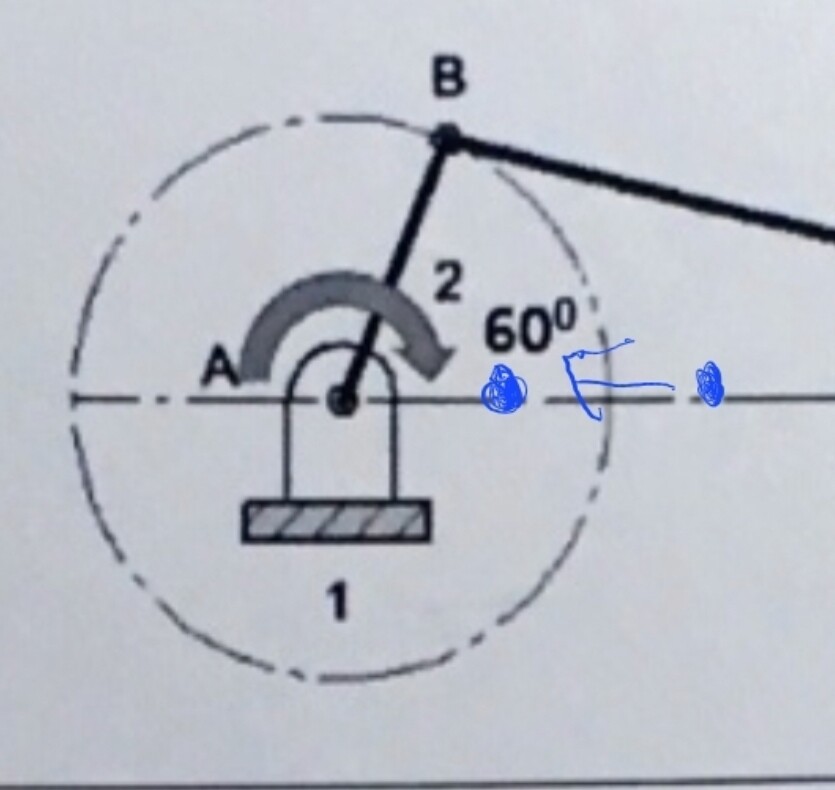

Hello, i am plannig to build a crank and slider system but the problem is for the crank wheel. I wanted to measure the slider's speed when it passes through a certain angle. I am planning to use an ir sensor for the speed. Is there any way i can set when the ir sensor records the the speed ? I need to do this project in my university.

So i can put a reflective marker on the wheel like i shown in the picture and the ir sensor will detect everytime it rotates ?
Yes, very commonly used technique.
Of course, the instantaneous speed of the slider will change from 0 to some computable speed as the crank moves. Why not just measure the RPM of the wheel and compute the speed of the slider based on the angle?
