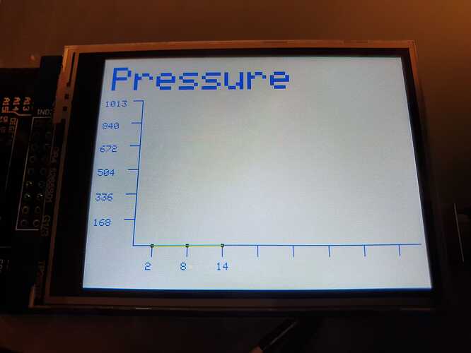

Hello,
I want to plot a graph of a pressure on an LCD Screen(Elegoo 2.8” TFT). The pressure is calculated from a Voltage reading I get from an ADC ( ADS1115). The equation for the pressure is: pressure = 10^(Voltage-5.5).

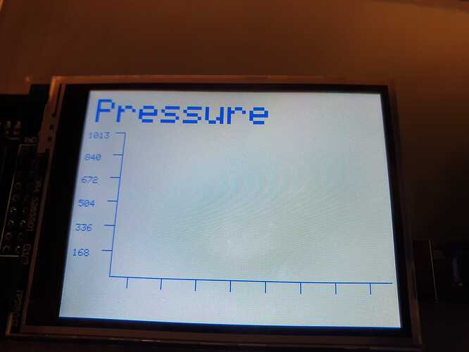

But as soon as i try to read out the ADC, it does not work anymore. I dont get a error message but the Graph does not plot any values.
What am i doing wrong?

So what does it do ? Is the value you are trying to plot zero by any chance ? What do you see if you print the raw ADC value and any intermediate values of the calculation to the Serial monitor and do they look reasonable ?
No, i tried different voltages, that show a pressure of around 1000 mbar if i run the Code isolated. Even if the value is zero, i would be able to see the Graph plotting this value in 6 s intervals.
If i run the code(with the graph) with the lines for the ADC the Graph does not show zero.
It does not even count up in 6 s intervals (as it does, when i just write a value for the pressure). It looks like it froze.
If i use the Serial.print (pressure_mbar) command or the Serial.print (volts0) command, i don't get anything on the serial monitor.
This is what it looks like, if the pressure is 0:
And this is what it looks like, if i try to run it with the code for the ADC:

Strong hint: If you want help with code, post ALL of it. The snippets are useless.
You won't be able to debug the code until you fix that problem, which is completely unrelated to plotting.
The real problem is that you copied someone else's plotting code, and modified it without understanding how it works.
A much better approach is to start with a very simple example that plots a few things on the TFT screen, and make sure that you understand what every single line of code does before jumping in to a large application.

If your 'proDebug' variable is set to true you will get serial output.
You might want to bring your baud rate into the modern world...
I tried setting the 'proDebug' variable to 1. Still nothing on the serial monitor...
I also changed the baud rate as you suggested.

It would be an excellent idea to print something during startup, e.g.
  if(proDebug)
    while(!Serial) {};
    Serial.println(F("Plot program V 0.1"));
as well as to make sure that the serial monitor program and your code are set to the same serial Baud rate.
PS: I glanced through the plot code, and when I see crap like this, I wonder why it ever worked, and would be strongly tempted to delete the entire package and look elsewhere for inspiration:
  uint16_t identifier = tft.readID();
  identifier=0x9341;
  tft.begin(identifier);
There are plenty of other problems with the code, so be warned!
