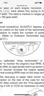

tach manual Looks like the dial on the back of the gauge may refer to something different than I first expected. See page 3, but it is related to pulses someway or another.

This appears to be the relevant sentence from page 3 under "4 cycle engines".
The correct tachometer will have a white label on the side indicating which switch position is for each engine type. This label will include 4, 6, and 8 cylinder engines for positions 1, 2 and 3.
Alright so it appears this tach is set up properly. Although a bit counter-intuitive that the V8, which has 4 pulses off the ignition coil per rev, uses the tach dial setting of 3 on this Faria gauge.
