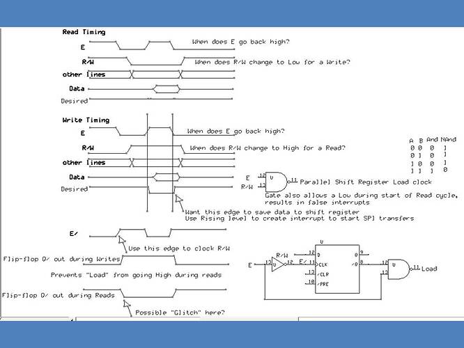

How are graphic LCDs typically used? Write data, couple of status reads, write data, couple of status reads? I could add a couple more gates and keep the read clocks out, that would allow more cycles to get the data.
Here's what I'm thinking of doing and my vision of how it would work.
[edit - fixed file name]

CrossRoads:
This web address was hidden your post.
http://www.crossroadsfencing.com/BobuinoRev17/LCD Capture timing.emf
(spaces in file names are not a good thing - as you can see above, it confuses many parsers......)
I can grab the file and download it but I don't know what it is. What kind of file is this?
The interface is always 8 bits as there is no 4 bit mode.

I fixed the file name Bill. The file type was described as "metafile, scalable", (.emf) it shows up as a nice drawing in the forum for me.
What I want to do is capture the data that is being written to the LCD and pass it in to a PC where it can be displayed remotely. The PC will take care of interpreting the data and making it viewable.
When I refer to clocks, I am trying to use the 2nd falling edge of the Enable line to clock data into a parallel-in/serial out shift register (2 of them to capture the 8 data and 4 other lines).
http://ics.nxp.com/products/hc/datasheet/74hc597.74hct597.pdf
Pin 12, the edge triggered Storage Clock Input
Then pull the Parallel load pin low to move the data into the output shift register, and read it out via SPI.
Figured E & R/W could be hardware logic manipulted to create the Storage Clock to the shift register and interrupt the ATMega so it could do the SPI.transfers. The SS pin would do the parallel load function, and SCK/MISO would pull the data in.
The display is part of a high tech coffee machine, the display is updated in response to users pushing buttons, so I'm thinking it will not be changing all that much, but I haven't seen it in action myself.
I am not writing the PC software, just passing the data along via USB port (FTDI serial/SB adapter).

That makes it easier. I've now read the datasheet, and I don't see on the datasheet any indication of how long the host must wait after sending one data byte before sending the next. The implication is that the host must wait on the busy flag. So I think you will need to gate out the read requests as you propose.
I suggest you connect a scope to the E and R/W pins and measure the minimum time interval between one write request and the next, so you can see how long you have to clock the data out of the shift register via SPI.
bperrybap has pointed out that the timing could be tricky, however I suspect that the display is being drive by an mcu and the setup and hold times used will be much longer than the minimum values shown on the datasheet. You can check this with a scope too.
CrossRoads:
I suppose the other thing I could do is parallel capture the data using 20-pin octal register chips (like 74F374), and read it in parallel via two direct port reads. Would that be fast enough?
That depends on (amongst other things) what other ISRs are active on the MCU, e.g. timer 0 and hardware serial. Your interrupt might occur just after entering one of these ISRs, and unless interrupts are re-enabled inside that ISR, you will have to wait for it to complete before your interrupt gets serviced. It might be better to disable those two interrupts if you can manage without them.
As I said in my previous post, I think you need to scope the E and R/W lines to see how much time you have to read out the data before it gets overwritten.

Guys, thanks for all the advice on this.
I didn't think .emf was propriety as the free software from expresspcb.com offers the format as an export option, along with .bmp.
It looks really nice too. I did a screen capture, pasted into powerpoint, and saved as a .jpg.
Unfortunately I do not have access to the machine, the fellow I am working with who does is located I don't where and is a mechanical engineer and this stuff just goes over his head. I'll pass along your questions and ask him to see what he can find out.
I have a few comments on your diagram:
  1. I think your comment "Gate also allows a Low during start of Read cycle..." is wrong. What the read-cycle diagram that you copied from the datasheet shows is a read cycle after the end of a write cycle, rather than a read cycle in isolation. So I don't think you will get any false interrupts from read cycles.
  2. The answer to "When does E go back high?" is when the host initiates a new read or write cycle.
  3. If you are using the 74HC597, then I would use the 2-input nand gate, connect the output of the nand gate to STCP and hold PL permanently low, so that the data is transferred directly into the shift register when E goes low at the end of a write cycle. Also use the nand gate output to generate the interrupt.
  4. If timing is more critical, then you could use the input latches as a 1-event buffer something like this:
  • have the output of the nand gate clock a D-type latch as well as the STCP clock of the 74HC597
  • have the output of the D-type latch generate the interrupt and also make it readable through an input pin
  • have an output pin controlling PL and also going to the reset input of the flip flop
  • hold this output pin high normally
  • in the ISR, pulse the PL pin low and high again. This transfers the data to the shift register and also resets the interrupt
  • then shift the data out via SPI
  • in the meantime, another write cycle may take place, causing the new data to be latched in the input register
  • at the end of the ISR, read the state of the D latch to see if another cycle took place. If so, go back to the start of the ISR. If not, exit the ISR.
This allows you to process multiple writes without returning from the ISR each time, and allows another write to occur before you have finished shifting out the data from the first.

You will need to save all the control lines:
R/W, CS1, CS2, and D/I as well as the 8 data bits.
I just noticed that the timing diagram signal names does not match their pinout signal names (typical for these types of display)
All the control lines R/W, DI, and the chip selects are supposed to be setup before E is raised.
(tAS which is 140ns)
Think of E being high as the output enable signal to the glcd for the data bus.
And the R/W determines whether the data bus is driven or used as input.
However.....
Pretty much every ks0108 AVR library I've looked at violates that tAS timing requirement.
In fact some set them simultaneously set some of the control lines with the raising of E, which clearly violates
having them set up prior to raising E. Yet this does seem to work on most glcds.
I chose to honor tAS, so the glcd library does honor tAS.
So you may have to actually look to see what they are really doing vs what
they are supposed to be doing.

Thanks Bill.
Getting screens ready to post goes quick, been doing it that way for quite a while.
Having it as powerpont also lets me add arrows, notes, etc when I want to.
Having to upload outside of the forum is a pain.
Is it possible the display uses a different chip? Datasheet says
"The display control instructions control the internal state of the NT7108. Instruction is received from MPU to NT7108 for the display control."
http://www.crystalfontz.com/controllers/NT7108DS_Rev011737530691.3_20060607.pdf
Is the timing similar to ks0108 timing?
I had planned to capture the 4 lines and the 8 data lines.
Thanks for the follow up.
You can use faststone to quickly add text on top of graphic images.
I liked it because it worked on Windows and avoided having to use a Microsoft based tool.
I found that the Microsoft tools tended to dork with the images and it is quite difficult
to maintain image quality.
That chip, including the timing works the same as the chips used in the "ks0108" modules.
