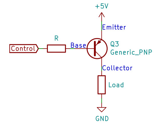

Reading mutliple VL53L0X sensors
Actually the Xshut pins are supposed to be used when connecting multiple VL53L0X sensors, to turn off and turn on sensors to assign different addresses.
But what if i connect according to the following schmatic
And controlling the vcc pins using the pwm of arduino to turn it on and off using the following code

This code works and gives the correct readings of both the sensors.
Q1. Can the above method be used? Am i doing anything wrong or harming the sensors in anyway? If not then what is the point of xshut pin?

  • Try using P channel MOSFET HIGH Side switches.
Use a logic level MOSFET.
Is there any issue if I don't use a mosfet
  • A MOSFET would be best but you could try a PNP BJT.
VL datasheet gives typical current draw of 19mA with absolute max peak of 40mA.
That's on high side to be powered from arduino pin. Depending what arduino you use.
For uno max current draw from pin afaik is 20mA / peak 40mA, so there's no tolerance left if you power VL from pin.
Some arduinos have max 8mA.
While it might work without problems, I suggest transistor circuit on post above.
Or use xshut.
