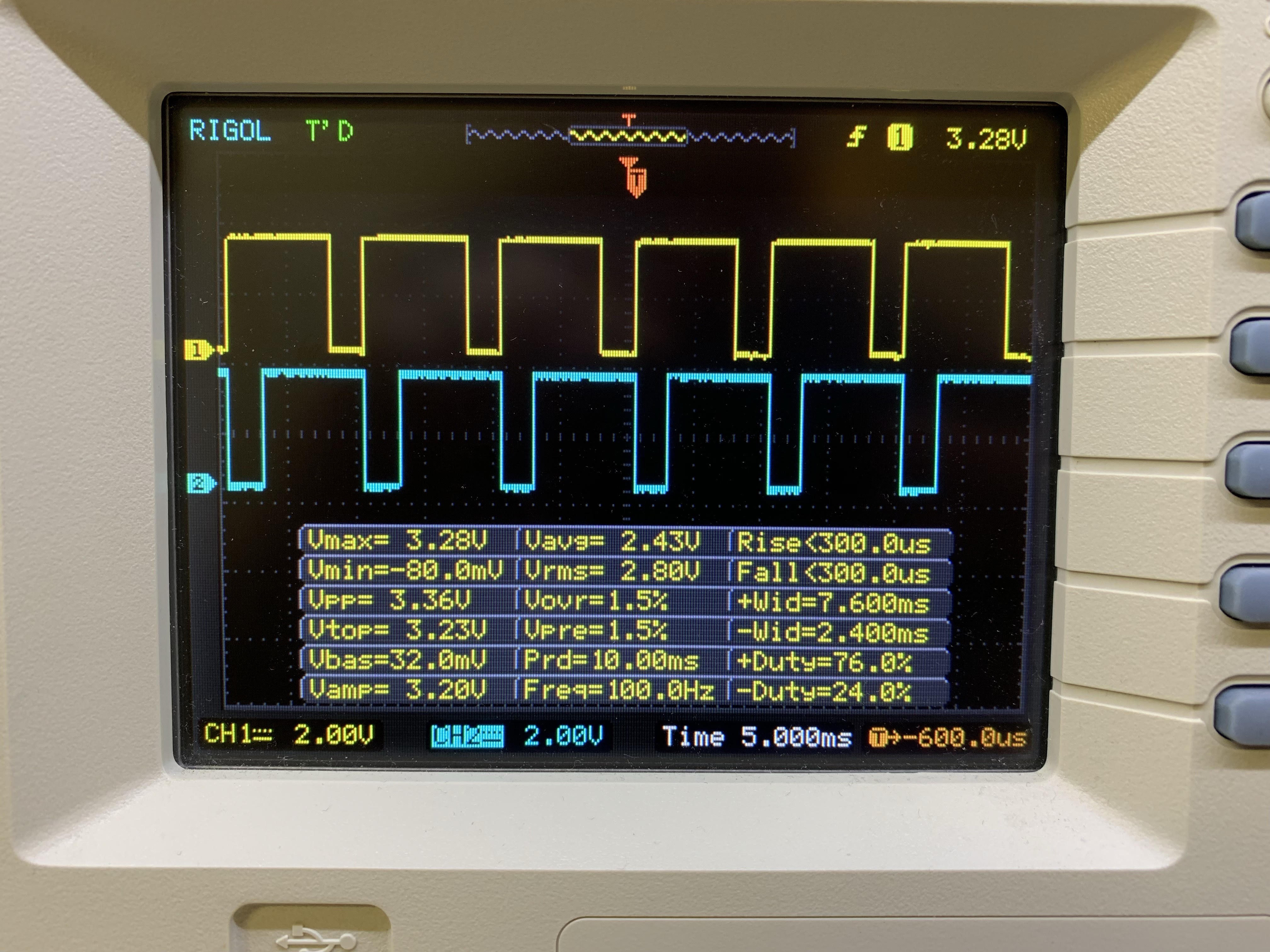

Display is using 3.3V input. I figure it out with scope that signal between two number is delayed by 2.5 ms. Display is with common cathodes. I mean it should be because segments are turning on when multimeter + probe is on “number pin” and multimeter - probe is the current segment pin. When I try other way around with probes, segments are not lightning up.
Scope picture is included in attachment.

OK, you are getting some of the ideas about how to use the forum. Here is your scope image:
I can see the logic in your code - you use the cathode drivers as interrupt sources to read each digit. That is the logical way to do it though I cannot see why you have "number" as an intermediary in some interrupt routines and not others. Never mind. :grinning:
The problem which I foresaw, is this: Your scope display (is that a photograph, or virtual?) is apparently showing the drive on two cathode commons. It seems to be quite "stiff", driven by a totem pole. I gather you have "piggy-backed" connections to the display and are attempting to read the anodes. These are red LEDs and their voltage will be about 2.0 V with current limiting resistors between them and the 3.3 V drive. This means they never reach a logic HIGH on a 5 V Mega 2560 (or any other 5 V Arduino).
End of story.
Paul__B, thanks a lot. Scope is showing two 1st and 2nd number pin voltage of 4 of them. And yes, ist a photo. All 4 "number" pins are on the same cathode as well as pins for each segment of the display. I post the photo to show you to see the frequency and the voltage. So is it possible to read those pins with Arduino DUE, because it seems that this model have 3,3 V digital pins?

danielkulo: So is it possible to read those pins with Arduino DUE, because it seems that this model have 3,3 V digital pins?
Yes, that would probably work, but an alternative would be to use one or two 74HC*T*14s as level shifters. One would probably suffice since you can figure out what the digits are with only six of the seven segments - I leave you to figure out which. A DUE sounds like major overkill. :astonished:
