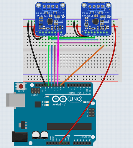

Hi there,
I want to measure temperature data from **two PT100** (2-wire) temperature sensors. I have looked around at different threads but still don't know how I should tackle this.
Until now, I used only **one** PT100 in conjunction with a MAX31865 amplifier and a Arduino Uno board. This worked well.
Now I want to use **two PT100 sensors** , and I am a bit lost on how to do so. At first, I thought I needed a second Arduino Uno board and a second MAX31865 amplifier and read the data from two different USB ports from my PC. But this isn't possible?
What is the easiest way to achieve this? Can I read the data from two PT100 sensors with only one Arduino Uno board? Because with one PT100 I am already using the Arduino Uno digital 10,11,12,13 pins (with CS, SDI, SDO, CLK)?
I am a beginner so am grateful for any help you could provide me.
Kindly,
Fernand

The second MAX31865 can share same SDI, SDO, CLK. It will need a different pin for CS.

Hi PaulRB, thanks so much for your message!
So if I understand correctly, I should buy another MAX31865 amplifier? Then I will have two CS, SDI, SDO, CLK pins on both MAX31865.
But if I have one Arduino Uno, how do I connect the two SDI, SDO, CLK, CS to the Arduino?
- The first PT100 I connect to the MAX31865 and then to the 10,11,12,13 digital pins.
- Where do I connect the MAX31865 SDI, SDO, CLK, CS pins of the **second MAX31865** amplifier to the Arduino Uno?
Can I use the other digital pins, for example 4,5,6,7 digital pins?

Here is how you connect two
 ![image](https://europe1.discourse-cdn.com/arduino/original/4X/1/6/7/167794096961e693eb080b147be36623c52175e5.png)

Awesome Jim, thank you so much. This was exactly what I was looking for!!
So now my last question, how do I modify the code of the unique PT100 reading to dual PT100 readings?
The code I used for one PT100 with MAX31865 is the following:

Could you tell me how to modify it to incorporate a reading of another PT100? Can I find the code somewhere?
Kindly, Fernand

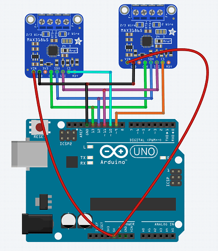

I only made 3 changes as marked.
I think you can figure out what changes you need to do in the loop()
There are now two thermos, thermo1 and thermo2
```arduino
#include <Adafruit_MAX31865.h>
// Use software SPI: CS, DI, DO, CLK
//Adafruit_MAX31865 thermo = Adafruit_MAX31865(10, 11, 12, 13);
// use hardware SPI, just pass in the CS pin
Adafruit_MAX31865 thermo1 = Adafruit_MAX31865(10); // ********** JIM
Adafruit_MAX31865 thermo2 = Adafruit_MAX31865(9); // ********** JIM

On a breadboard
 ![image](https://europe1.discourse-cdn.com/arduino/original/4X/e/3/b/e3b4e6597b426e5f8e722dcd8b9d247982f758d6.png)

> [@fbmeca](#):
The easiest way to connect 2 RTDs to an UNO is to stay with software SPI. It's a bit slower and uses 4 more pins but the connection is easier without a breadboard. A bit slower doesn't matter if you are reading temps once a second.
Change kolaha's code to
```arduino
Adafruit_MAX31865 thermo1 = Adafruit_MAX31865(10, 11, 12, 13);
Adafruit_MAX31865 thermo2 = Adafruit_MAX31865(6, 7, 8, 9);
and connect the second RTD to pins 6, 7, 8, 9

Thank you Jim for the wiring visualization, that really helps and is exactly what I was looking for!
