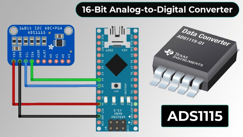

You could try your initial idea of amplifying the signal with an opamp. But a much better and easier solution would be to use an external ADC like the ADS1115 board:
It even has a Programmable Gain Amplifier, so it can amplify the signal before sampling. That together with the theoretical 16 bits, should be more than enough for what you need, I suppose.

If it was my project I'd probably use an ADS1015 12-Bit ADC like this one from Adafruit. Use its PGA in an auto-ranging scheme to get the resolution at the low voltage you are interested in.

Better ADC(ADS1115), with PGA, suggested in post #12 or thereabouts; perhaps OP wasn't yet 'ready' for a better idea.
With builtin reference and gain as needed, the OP should be well ahead by now.

As I found an ads1115 board, I tested it comparing with the arduino mega 2560 a/d: no match!
I simulated the analog input with a multiturn pot, but the arduino a/d does not 'stay still' ( had to use 10000 samples to have better results ), the ads1115 is ok, super stable ( used 10 samples )
Atthached the two codes, both contain a two point calibration ( initialized with some values )
