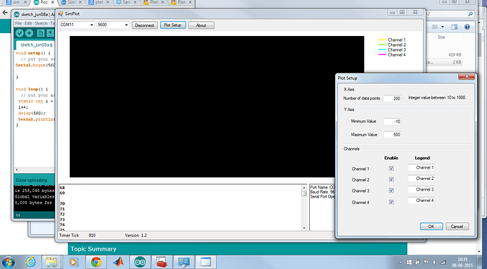

My friend recommended this as a really good, simple-to-use plotting software so I'm using it to tune a PID controller. However, I'm not able to get it to work. When I set up the port and baud rate and press connect, the serial data gets printed correctly in the monitor but the plotting window remains blank. I verified the plot set-up to make sure that the data being printed is within range. I've attached a picture that demonstrates this.
I'd be very grateful if someone could point out what I'm doing wrong.
Thanks!
