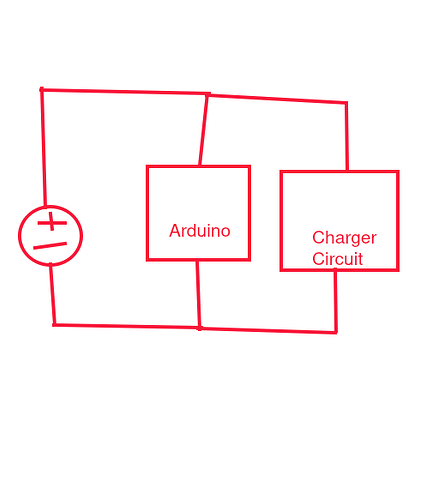

  1. The circuit will always be on but it's only really used for 2 hour per day. The battery would just be a Li-ion battery.
Do you think I could wire my battery charger circuit in parallel with the arduino like the picture included? This seems like the simplest implementation since the 9 volt battery will always be plugged into the arduino. I'm worried that this won't work since the arduino will always be on.
Nevermind I found a TP4056 module that seem to do this exact job. Thanks for your input and help.
