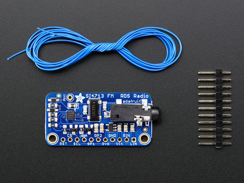

FM transmitter + RDS:

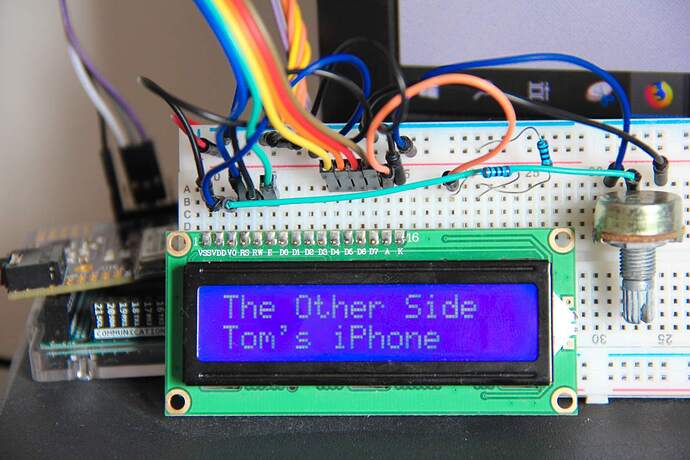

Accessing bluetooth metadata from RN52:
Idea: use a bluetooth shield that gets audio to 3.5mm jack, and just short that shield to this shield.
Use bluetooth shield metadata to feed RDS.
