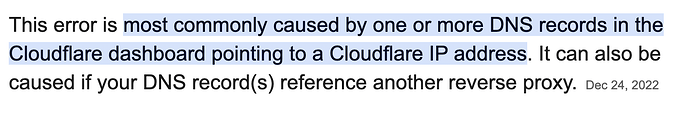

Although the focus has changed from spiffs v. littlefs to Firebase, your previous thread has some useful information so I post the link here: LittleFS mount failed Error - #32 by chamika2003
Your error message:
From here, you seem to have a basic problem posting anything to firebase. That was a simple float.
I think the best approach is to write a much simpler program which simply attempts to post a basic data set to Firebase, completely separate from your main code and focus on solving the problems with that. I don't know Firebase at all but I could imagine that, if you are using a free service, there could be restrictions on how much and how often you can send data.
There are a number of Firebase tutorials and there may be ways of getting better error messages from it.

You said you could not find any info re HTTP 1000 error. I found lot's of information, here is the top reason
I got the error. are there any way to modify my full code to use new library. bcz i spent full week with this old library.
You must not use that old library, it will be nothing but trouble. KISS, and divide and conquer.
Of course there is, shouldn't be much different.
