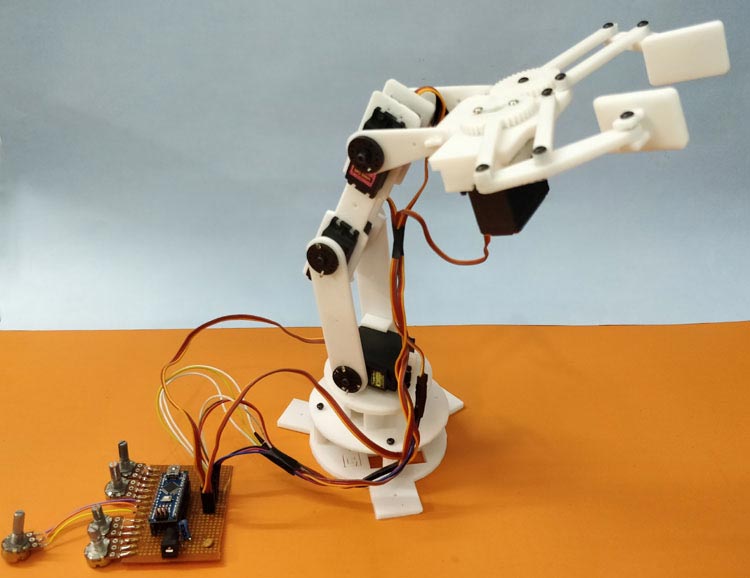

Here is a similar example but for a robotic arm with 5 servo motors. That should be enough for you.
do you know of one that uses arduino uno? this one uses nano and i cant seem to get the same effect out of it, i also am so confused on how you press r and p
Why not? Arduino Nano and Arduino Uno use ATmega328, the difference is that Nano has 2 additional analog inputs. Everything else is equal. The Uno is not convenient for a prototyping board because it is larger in size. I only use Nano. Buttons R and P are commands sent over the serial connection through the serial monitor from the Arduino IDE. Did you watch the clip? It looks good there. If you want independent work without a computer, you can do it through 2 buttons to Arduino. Looks like you still have a lot to learn. The important thing is not to give up and to be persistent.
