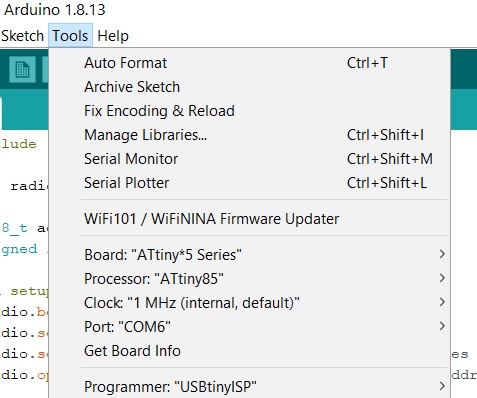

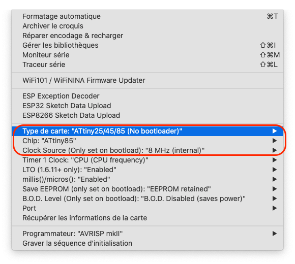

I got the same compile error with my new code. I just try the code you summit and get a different error
Arduino: 1.8.13 (Windows 10), Board: "ATtiny*5 Series, ATtiny85, 8 MHz (internal)"

Yes I follow this instructables example
OK
you probably did not install ATTinyCore which is the version you need in the board manager
see this note for ATTiny in the RF24 documentation
(il y a un forum en français si vous voulez)

Sans titre
already successful to compile simple code and upload to ATtiny85
This does not look like the same UI for board definition
seems you have installed this board manager and got the ATTiny package
https://raw.githubusercontent.com/damellis/attiny/ide-1.6.x-boards-manager/package_damellis_attiny_index.json
and not ATTinyCore you get with http://drazzy.com/package_drazzy.com_index.json in preferences
You got it :muscle:
