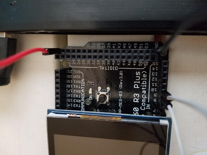

Hello please find the pictures of the circuit attached.
Delta_G:
Can you describe? How much do they fluctuate? What are the errors? I shouldn't be having to pump you for information. If you want help then don't be terse, go ahead and write a little bit and tell us what is going on. Which component was it that started this trouble. You didn't go straight from the code in #2 to the code in the OP without any testing did you?
It would still help to see. There may be some electrical issues with the other sensors being connected. Who knows. But if you don't show me then I can't help you. I can't debug something I can't see. You have to understand that. If you want help then come on with the details.
Hello,
The reading fluctuates from -10 to +30 degrees when running the code combined with other code. The error is that the temp is fluctuating.

Show your wiring diagram. If you don't have a proper schematic-drawing program a pencil sketch on a napkin is acceptable.
Sensors like pH sensors tend to have very harsh peaks of current usage. That upsets other sensors using the same power source as their reference voltage.
Of course a digital temperature sensor like the DS18B20 has much less problems with that and it's easier to read than the LM35.

im using the phidgits ORP/PH 1130 pH shield
So do you think if its current usage then just providing a high amperage power supply should solve the issue.
Ill look into the digital temp sensor.
Im getting more and better pics together.
hope this helps with the wiring.
No. That does not help. Draw a diagram on paper. Photograph that.
Try to use standard symbols but you don't need to waste time getting the symbols perfect. Each component can be a square box with the inputs and outputs labelled by pin number and function is actually the best way to draw it.
