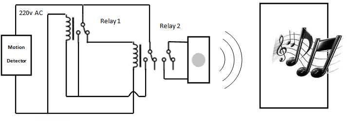

Thanks. I thought about a 555 circuit but had the impression they were more or less obselete these days and it would mean havng to have a low dc voltage to power the circuit. I also thought about a mechanical rather than electronic solution using two relays - see diagram. I was kind of hoping there might be a nicer, neater solution!

Yeah ok but the last time I mentioned it I got the strong impression it was outdated. Anyway it seems like there isn't a neat solution, at least not an obvious one so the double relay might actually be a contender.
The 555 timer has been around for a long time, and some scoff at it, but it is still a lot simpler to use for simple tasks.
I think what you've drawn might work. Although you might need to do something to slow the relay on the left a bit. If it were DC, I'd suggest a shorted turn around the relay coil, but that won't do for AC. A bit more mass on the contacts, maybe?
Have you tried it yet? I don't see any inherent problems with it. Although the relay coils are inductive loads and so will cause arcing, an RC series snubber could solve that, and a relay is a very light load for another relay to switch, so maybe not necessary to worry about it.

Just tried it and it doesn't work. Yes I need more than a few milliseconds. I'm not keen with mains voltage, least of all messing around with the relay. Even if I got it working with weights or such I'd surely end up throwing the house into darkness at the least convenient time in the near future - probably when the wife is alone!

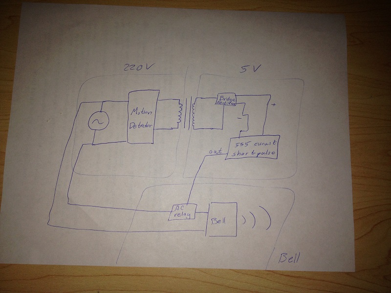

I am currently a college student and so by no means am I guaranteeing this circuit will work, but out of curiosity after reading this thread I drew up a circuit I thought might work. If it doesn't work no worries and I will remove it or correct it and change the picture.
Crop and resample, please. 3264x2448 pixels is -way- to big.
My apologies I took the picture with my phone and had no idea it was so large, I just re-sized the image.
I think the OP was hoping for a schematic, not a block diagram.
I'll try to find some time to draw something up later today.
