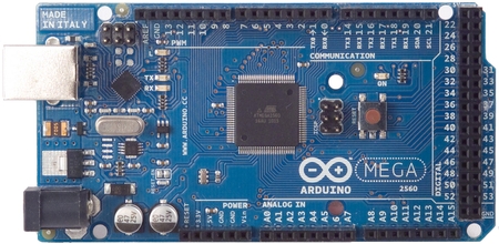

here is the MEGA 2560
http://arduino.cc/en/uploads/Main/ArduinoMega2560_r2_front_450px.jpg
