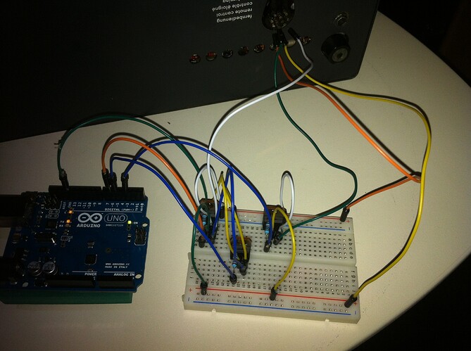

I am trying to build remote control for my reel to reel, so i can control it from my computer. I managed to get the play and the stop button to work, but when I hook up the rewind it doesn't play anymore it rewinds no matter if I press play or rewind.
Maybe one of you has an idea. Thanks in advance.

Of course sorry. I am using TIP 122 transistors. I hope you can see all you need to see otherwise I am very happy to comment on it.
Hi, I see you are using a socket in the side of the tape player, is this the socket used for the cord version of the remote.
If it is ,do you have it or a diagram.
Also a diagram of your adrunio, power supply and connections to the socket would help, post a CAD or picture of hand drawn circuit.
I would not be connecting the arduino the way you have, I'd have used small relays so as to provide isolation between the arduino and the tape deck.
Tom... :slight_smile:
Aside from power, the transistors provide some degree of isolation between them. As long as the voltage source is a reasonably clean +5v, I would personally have no qualms with this setup. Although, the well-being of the deck strikes me as something to be concerned about. At least more than a cheap (inexpensive) dev board. :wink: So be careful in there!
On that note... What do you know about the push-button controls? Are they simply grounding a particular signal when the button is pressed?
