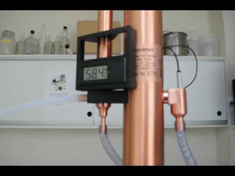

Hi, I’m currently manually adjusting a water flow valve to regulate/maintain the cooling water temperature on a still (for making alcohol).
I want this to be automated using Arduino as it’s a five hour process and I think it will be fun.
I need someone who would be willing to figure out a parts list for me to buy and to program the code required to run the program. Or someone who can point me in the right code direction. Arduino is something I’m definitely keen on getting immersed into, I think this would be an easy project for that someone who can help and a great “chucked in the deep end” project for me. I’m really good with electronics and have made many projects, it’s the code and the how that I’m not familiar with.
Ok so the still requires cooling water to pass through the condenser coil to condense the alcohol. The temperature range that this cooling water needs to stay in is, no less than 50°C and no more than 65°C. At the moment I turn a pin valve to increase or decrease water flow to raise and lower the temperature. The water is pumped from a basic pond pump at a rate of about 400-500mlh. So it’s not high pressure or large volumes of water. The piping is about 1/8 inch clear flexible hose.
My thoughts are either the pump can be the variable (Increase or decrease the speed of a water pump) to regulate flow. OR, a water control valve with a servo? The adjustments I make manually on the pin valve to change the flow are really minor and it doesn’t seem like much change in ‘water flow’ although the temperature will move 2-3°C with this small adjustment.
I’m not standing there the whole time either, once it gets up and running I can leave it for hrs before I need to make adjustments, it can fluctuate between 51-55° on its own and isn’t a problem. I do monitor it with a baby monitor and have even done a FaceTime call to monitor the temp! Hehe
I can take some pics of the setup as is (not sure if that helps) I can also take a video of it working and me adjusting the temperature with the pin valve. 🙂
Thanks in advance
Dan

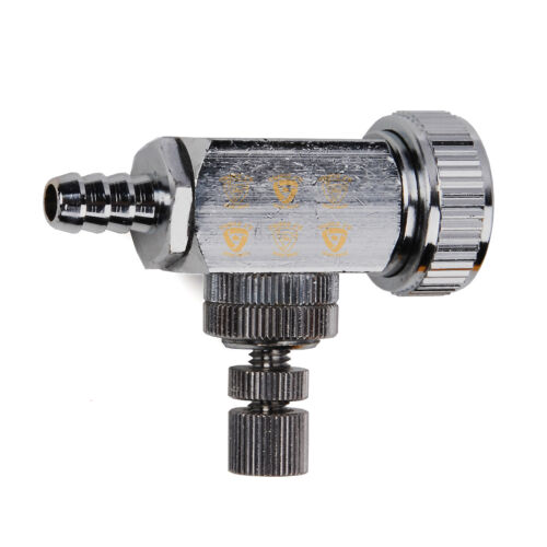

Hey guys thanks for the input! And apologies for some missing essential info!
Firstly the cooling water comes from the main water supply, so its cool. Then its pumped from a pond [PUMP](http://http//https://www.ebay.com.au/itm/220V-240V-PH-Submersible-Water-Pump-Aquarium-Fish-Tank-Pond-Fountain-Marine/113847238336?hash=item1a81d2fec0:m:mYEs6ha9QnY02UVFHuUGBVA)to the pin valve.
I have a feeling that the pond pump is AC and non adjustable, i'm more than happy to get a good DC water pump that is adjustable by changing the voltage.
The pin [VALVE](http://http//https://www.ebay.com.au/i/383163707378?chn=ps&norover=1&mkevt=1&mkrid=705-139619-5960-0&mkcid=2&itemid=383163707378&targetid=752504799344&device=c&mktype=pla&googleloc=9070624&poi=&campaignid=7412621919&mkgroupid=80280724785&rlsatarget=pla-752504799344&abcId=1139426&merchantid=7616912&gclid=EAIaIQobChMI1Kqyzo_s5QIV2DUrCh36vgBNEAYYAyABEgK3jfD_BwE)simply restricts the flow of water by turning the knob.
The cool 'Tap' water then travels through a hose and attaches to the condenser coil on the outside of the still, the water then travels internally (Cooling/condensing the alcohol) and in turn, the cooling water becomes hot and exits via another pipe (I then direct that hot water into the pool). At the point where the hot water comes out a digital [thermometer](http://http//https://www.ebay.com.au/i/123776450413?chn=ps&norover=1&mkevt=1&mkrid=705-139619-5960-0&mkcid=2&itemid=123776450413&targetid=833807926494&device=c&mktype=pla&googleloc=9070624&poi=&campaignid=6472417595&mkgroupid=77265351546&rlsatarget=pla-833807926494&abcId=1141716&merchantid=107365660&gclid=EAIaIQobChMIiPvPy6Ps5QIVASUrCh02MgrTEAQYAyABEgKHevD_BwE)has its probe mounted and submersed in the hot water. This is the only temperature reading I use to maintain the temp between 50-65C.
The links dont work.....
POND PUMP:
[https://www.ebay.com.au/itm/220V-240V-PH-Submersible-Water-Pump-Aquarium-Fish-Tank-Pond-Fountain-Marine/113847238336?hash=item1a81d2fec0:m:mYEs6ha9QnY02UVFHuUGBVA](https://www.ebay.com.au/itm/220V-240V-PH-Submersible-Water-Pump-Aquarium-Fish-Tank-Pond-Fountain-Marine/113847238336?hash=item1a81d2fec0:m:mYEs6ha9QnY02UVFHuUGBVA)
PIN VALVE:
> **[New Still Spirits T500 Water Flow Controller & Adapters Home Brew Spirits...](https://www.ebay.com.au/itm/383163707378?chn=ps&norover=1&mkevt=1&mkrid=705-139619-5960-0&mkcid=2&itemid=383163707378&targetid=752504799344&device=c&mktype=pla&googleloc=9070624&poi=&campaignid=7412621919&mkgroupid=80280724785&rlsatarget=pla-752504799344&abcId=1139426&merchantid=7616912&gclid=EAIaIQobChMI4KDgmabs5QIV1SMrCh0BhgtvEAYYAyABEgJ_DPD_BwE)**
> Find many great new & used options and get the best deals for New Still Spirits T500 Water Flow Controller & Adapters Home Brew Spirits FP at the best online prices at eBay!

I'm not sure but an adjustable valve could be more expensive & complicated.. my feeling is cheaper and simpler to use a 12V DC bilge pump with a half bridge driver (even an L298N module might work) for PWM control. And a temperature sensor like the aforementioned DS18B20. It is cheap enough not to worth trying to connect to the existing digital thermometer. You can keep it as control.
here-s just an [example of such a pump](https://www.banggood.com/DC-12V-5_5M-1000LH-Brushless-Motor-Submersible-Water-Pump-p-1118173.html?gmcCountry=DE&currency=EUR&createTmp=1&utm_source=googleshopping&utm_medium=cpc_bgs&utm_content=frank&utm_campaign=ssc-de-all-0302&ad_id=337428325641&gclid=Cj0KCQiAtrnuBRDXARIsABiN-7CuPsYvGC6yTFMIUn_YNmjNuW5DdO5b5j3cIjJuJ_L3kmLyJsDk4S4aAnM9EALw_wcB&cur_warehouse=CN) which might have the right flow capacity.
PS
> The specs on the pump(15w=1000l or 40w=2500l) don't appear to be consistent with this earlier statement.
Yeah, that's a question. First I thought he meant 400-500l/h but If the hose is only 1/8 inch (3mm), diameter and the flow is still restricted by the valve , the pump should be quite choked.

Thanks, try this link:
[http://www.alltech.com.au/en/home-garden/519-lcd-digital-thermometer-for-fridge-freezer-aquarium.html?gclid=Cj0KCQiAtrnuBRDXARIsABiN-7B8X7VuX9uKS1oPRLKyG42MXL2UnowoAZsNKuXEeZq10xX6\_kcJ488aAknAEALw\_wcB](http://www.alltech.com.au/en/home-garden/519-lcd-digital-thermometer-for-fridge-freezer-aquarium.html?gclid=Cj0KCQiAtrnuBRDXARIsABiN-7B8X7VuX9uKS1oPRLKyG42MXL2UnowoAZsNKuXEeZq10xX6_kcJ488aAknAEALw_wcB)
I’m more than happy to purchase an Arduino temp module. I’m hoping this can come in around $50-80 AUS for parts and similar for someone to write the code and help. I have little experience with code but it’s definitely not beyond me, I’m going to get a UNO kit today and start a few projects.
The pump will be choked up for sure, I needed to get one with the highest head lift otherwise it just doesn’t push the water up through the still. The pump sits on a bench right next to the still and before everything heats up I do indeed measure the flow rate with a bucket, the recommended flow rate from manufacturers is 400-500ml per minute, I said per hour before sorry bout that! I measure this from the outlet hose of the still.
[![](https://europe1.discourse-cdn.com/arduino/original/4X/5/f/8/5f80fbc595f2b4dc38ffea8ab3e663bda3d8c041.jpeg "Close up on how to use Still Spirits Turbo 500 - cooling water and distillation explained") ](https://www.youtube.com/watch?v=Q1p0RHtBEfw)
That’s not me... But that exactly the same setup. The only difference is I pump the water through.
Appreciate it guys
