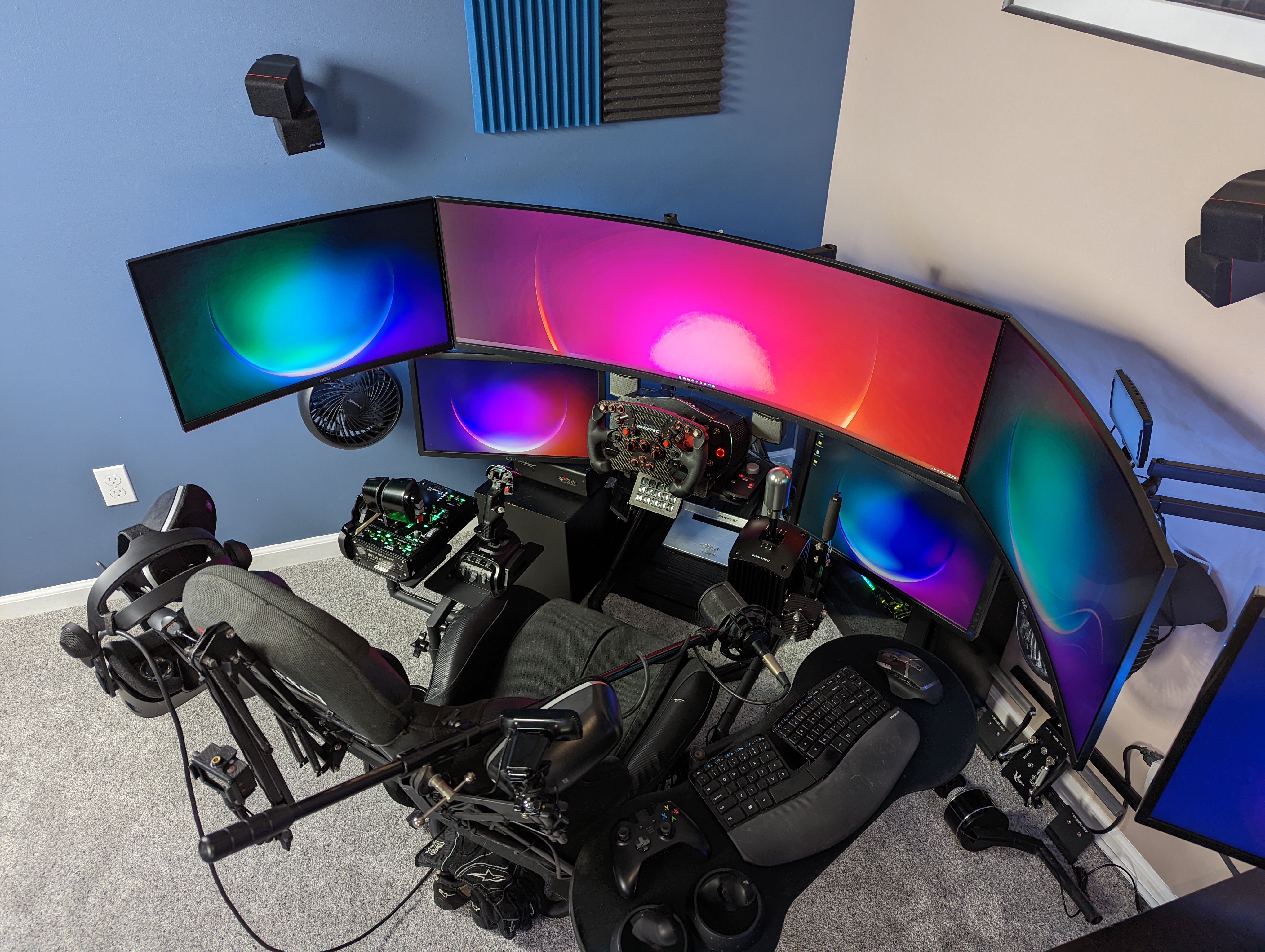

For context and to help understand why I'm using 120vac fans here is a picture of my sim setup. You'll see the 2 fans flanking both sides just under the outer monitors. Those are what will be controlled, it would be rather difficult given my space constraints to go with ducted 12v fans.
Thanks one last time for the concern, hopefully for the last time I can assure you it's well taken and I'll have zero issues. Mostly thanks for all the information, I'm looking forward to my starter kit showing up so I can build some really simple stuff before jumping into this.

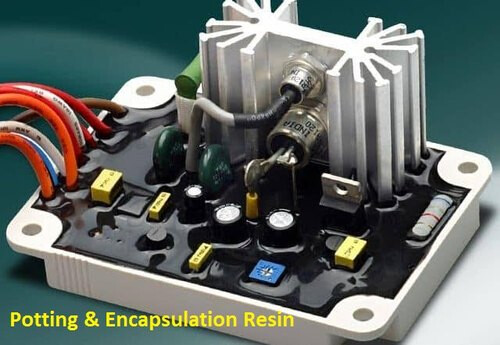

I'm referring to the additional layer of epoxy on top of the finished PCB. It's usually a "flood fill" into the product/case but it can also be done in a mold so the PCB can be taken out later
You will see that on certain high-voltage boards (e.g. water heater main board), boards that might be working in humid conditions (e.g. secondary under-sink controller), or boards that contain high-power circuitry (e.g. Dyson Battery Pack)
Like this
.. ok not epoxy. resin. not too different.
Except for the boards at my home the resin is see-thru
