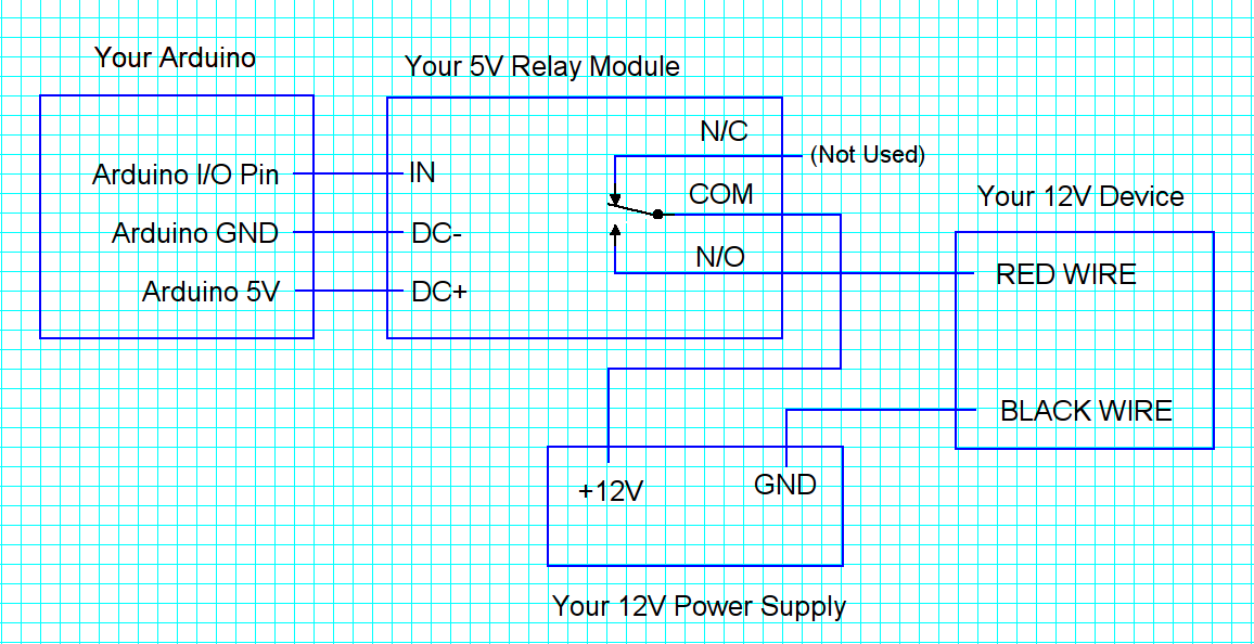

Attached is a sketch of how you will wire your device to your relay module oplaza.

Attached is a sketch of how you would wire up your system using a 5V relay module oplaza. It may clarify things for you. Note that there's no connection at all between your 12V power supply and your Arduino (and that's a good thing in general!)

Great, thanks so much, with this las sketch do i need to connect the Arduino to antes power supply? Ir with the 12v draen it Will turn on?
I have a hard time guessing what you mean with your last post... You still need to power your Arduino either via USB or via the barrel jack. If that answers your question. That's basically the only connection you need to make that's not shown in the last diagram.
