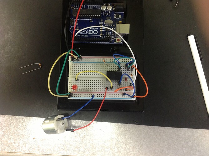

I learned how to work a relay. So I set up an led and a 6v motor. Led works, motor does not. Checked everything with multimeter, motor works fine, but as soon as I hook it up to relay, led works, but not motor. So I disconnect motor, wait for led to light up, hook up motor, led goes out. Disconnect motor, led lights up...?

Hope this helps. Basically, one of my tests was to replace the motor with an led. Like I said, led works just fine.

Schematics are indeed the lifeblood of true electrical design, without them you get yourself into a world of hurt very quickly. From the picture I can't tell exactly what is going on, but there are a couple of possibilities.
  1. The motor might need more power at 5V than the Arduino can supply. The 5V pin on the Arduino is only good for a few hundred milliamps, and that motor could draw more than that on startup. I don't think this is the problem as the motor came with the kit, but it is possible.
  2. In your picture it looks like the motor isn't connected to anything on one end. I assume you knew this and you were just switching it in and out, but either way double check your wiring and make sure no wires or leads pulled out of the breadboard.
  3. When you connect in the motor there should be NO resistors in series with it. The LED needs a series resistor or it will fry, but the motor needs all the current it can get. Follow the motor power from 5V to the Relay to the Motor and to Ground and make sure it never passes through a resistor along the way.

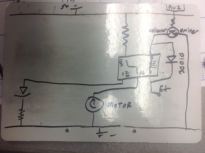

Sorry guys, did not mean to start a fight here. I get that you want me to learn on my own, but the truth is, I am very new to this, and I do not have money to blow arduinos. So in the end, I did post this to get an answer. I drew a sketch, and took out a resistor, killed an led. So right now, I have no clue what else to try.

You cannot have the LED and the motor in the same part of the circuit.
At the moment you have:
+ ---[M]----o/ o------|>|---/\/\/\/\---- -
... or something similar. Power flows through the motor to the relay, then through the LED and the resistor. That won't work.
Remove the LED and the resistor and just have the motor and relay:
+ ---[M]----o/ o----- -
If you want an LED, then it, and its resistor, must go in parallel with the motor:
+ --|                   |----o/ o----- -
    `--------[M]--------'

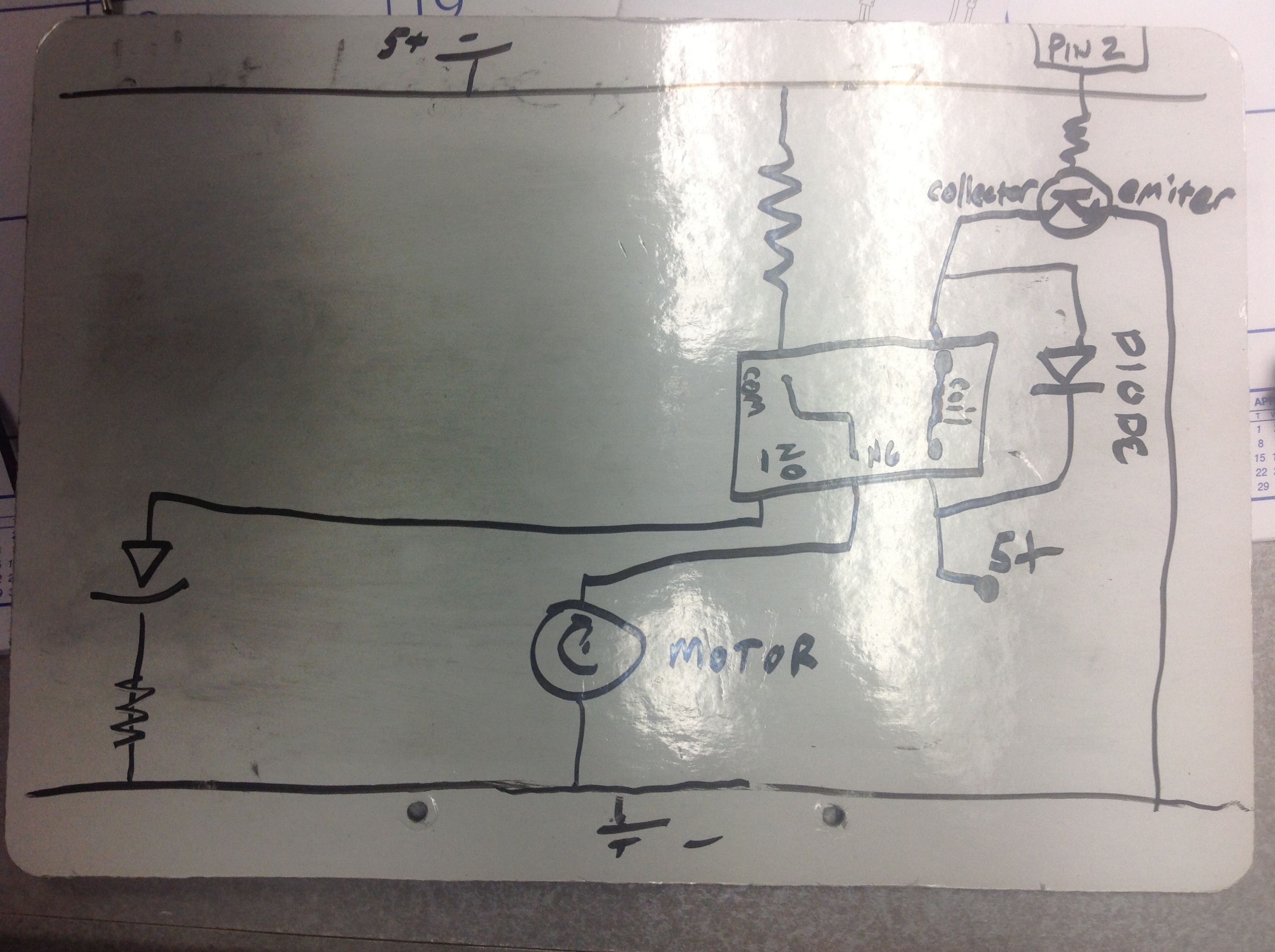

Hope this helps. To add, I also tried switching the motor from normally closed to normally open, and nothing. It took me awhile to figure how to sketch this, I apologize for the abscence.
It doesn't help that it's umop apisdn :wink:
Loose the resistor between NC and +5V.
