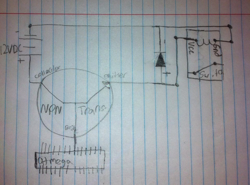

I am trying to build a relay circuit that when the base of a transistor is supplied 3.3v it allows current to flow and turn on a relay. I put a diode in parallel to prevent blowing my mcu or transistor. I am using a 12v relay, a arduino, a npn 222a transistor, a IN4002 diode, a arduino (sets pin high and supplies power to base of trans). It won't work at all for some reason? Any suggestions? Thanks.
Here is my schematic below.
Here is my breadboard.
Your schematic is wrong.
As an example, see:
Vcc to the coil #1 of the relay (pick one and it becomes #1)
coil connection #2 to collector (the other coil connection on the relay)
emitter to ground.
you are using an NPN, so it goes between the device and ground.
you need to add a relay from the Arduino to the base of the relay.
proper selection is important, but anything close would work.

You need a base resistor to prevent burning out the transistor and the
Arduino - the Vbe on a transistor is limited to 0.7V or so, so without
the resistor you would be shorting the Arduino pin to ground (almost).
Large currents would flow and the transistor and Arduino would be
beyond their abs. max. specs.
Arduino output pins are limited to an abs. max. of 40mA (that means stay
at ~25mA or below for reliable trouble-free operation). The switching
transistor needs a base current of perhaps 1/20th of the collector current
to saturate (means turn properly on)
For instance if the relay needs 0.2A, give the base 10mA with a 470 ohm resistor.
