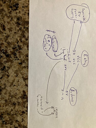

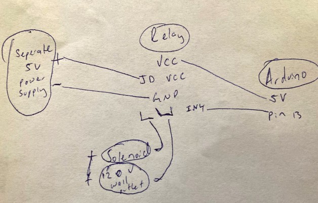

Hey all. I’m fairly new to this. I’m using an arduino to control a relay that activates a 12v solenoid valve. I will include my circuits below. The circuit works fine when the relay turns on, but as soon as it shuts off the code crashes. I’ve read about voltage spikes and snubber circuits. Can someone give me advice or a diagram on how to build one and where to put it in? Thanks in advance.

Can you give more information ?
Which Arduino board do you use, which relay module (with a link to where you bought it). Which solenoid is it ? Does it run at 120V AC ? What kind of separate power supply ? How is the Arduino powered ? and so on, and so on.

Typically, a diode is placed across the relay coil contacts.

So to be clear… the bottom right of my picture would be my updated circuit?

The diode goes in BACKWARDS with the cathode connected to the high side. This is a shunt diode that will short out the inductive kick when the field collapses as the relay/solenoid turns OFF. This is the same principle that a car ignition operates off, the field collapses when the points OPEN, causing the spark to form. The diode prevents this.

Interesting. Is it possible for you to add to my diagram so I can be certain? How do I know if I’m connecting the cathode to the high side?

The relay you linked to is a 4 channel relay module. I am seeing a diode at the base of each relay labeled D1, D2, D3 and D4 so I am guessing those are flyback diodes. I would also guess the 4 pin chips are Opto Isolators. The relay module board is designed so it should not be a problem. You may want to consider diodes across your solenoids like a 1N4002.

In the image you drew, you do not connect the GND of Arduino to the GND of the "separate power supply" for relay. Connecting two GNDs together.
