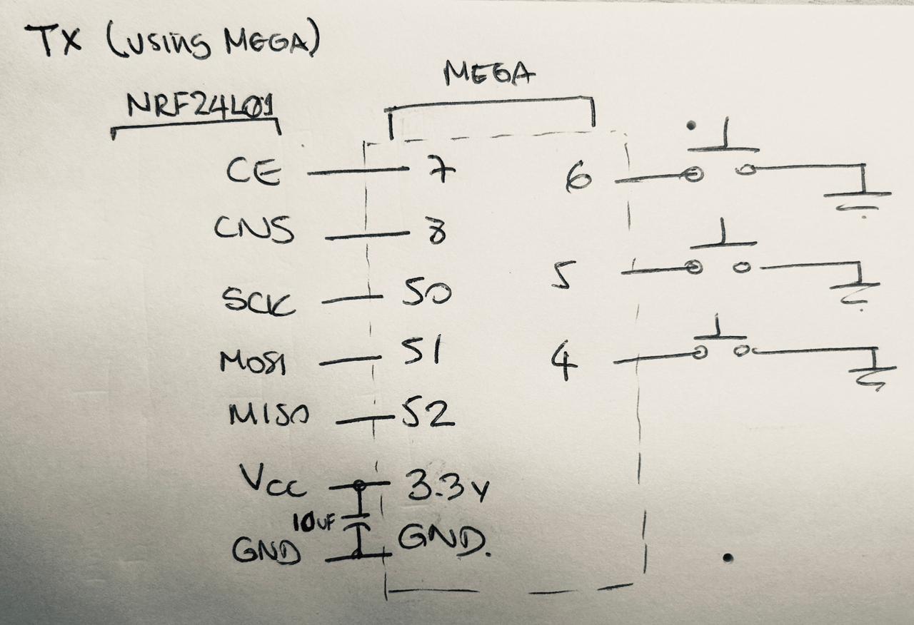

Hi @Wawa .
Thanks, you are right. I've already corrected it.
I replaced the Nano with another Mega, using its 3.3V and GND as the power supply, but the TX keeps displaying Message 2 with some message lines missing. I also ran a program that simply sent text TX->RX and RX->TX. Apparently it worked fine, except that in the serial monitor of the TX, the message from the RX wasn't displayed with the same fluidity as it was in the RX serial monitor.
Button 3 button rarely fails (you press it once, and temperature is displayed correctly on the TX serial monitor).
The other two, controlling the pumps, are the main issue (Button 1 and Button 2 keep the pumps running; releasing them stops the pumps). I've tested it with other buttons, and the same thing happens. Perhaps it's a coding issue.
COMPLETE CODES
TX CODE

Hi, @danielarg1990
You are using by the looks of it the PLUS version of the NRF, this requires more power.
Check the specs on your NRF unit.
Keep some separation between TX and RX, like 1m so that you do not overload the RX.
Wait, TX is the one that has the buttons, or does it? Your naming of the stations is getting confusing (at least for me). I'm going to assume the station with the buttons correctly displays each button press, but that the other station without buttons sometimes skips a beat. Correct? This would denote a radio problem.
When I was doing some projects with NRF transceivers, I ran into this issue a lot, too. I found that when there was no fault tolerance (i.e. I needed to make sure the signal was received), I had to resort to an acknowledgement routine, where the receiving station sends a checksum back to the sender within a given timeframe after the original payload message was sent.
In principle, the auto-ack feature of the NRF chip can manage this for you; google a bit on "NRF24 auto ack" and see if you can use it.
I've had an application where I didn't end up using auto-ack, but I used a manual/custom acknowledgement instead, which I did like this:

The problem with all things wireless is that regardless of what you do with PA's, antenna's, module placement/orientation etc, you always end up with data transfer problems sooner or later. They may be very infrequent, or they may happen all the time, depending on....the alignment of the planets!? It's really a crap-shoot. So that's why you see so much protocol overhead in wireless communications dedicated to error detection and recovery. And that's also why you see so many people asking "can you wire these things together instead" if someone suggests using a wireless link (evidently, your application requires wireless!)
When I press the button, the temperature sensor sends me only one measurement taken within a maximum range of 1 second. (This is to prevent multiple measurements while I press and release the button)
Hi @TomGeorge .
I used LM2596 modules to power each NRF24L01 separately, aiming for 3.3V output. However, they began behaving erratically, displaying symbols like '???' and 'Received from: ???'. As far as I know, the LM2596 is stable. They only function reliably when connected directly to the Arduino's VCC-GND. (Connection diagrams below)
Moreover, the NRF24L01 consumes 0.16mA while transmitting or receiving (which isn't too much for an Arduino, so it shouldn't cause message glitches on the TX side serial monitor). (See images below)... I'm already beginning to doubt my abilities :expressionless:
Ignore the background PCBs and actuators; they're not connected for testing.
Thank you @rsmls .
  1. Sorry for the confusion, I hope this image can clarify it:
  1. Nice tip! I'll look into the auto-ack feature. I'm encountering a similar issue where the message is sent and processed correctly, but the returned result is incomplete, particularly with "Message 2". It appears there's a discrepancy between the transmission and reception windows. I should consider implementing a time delay to ensure complete reception.
  2. And truth be told, I've tried so many things that I'm starting to consider it an RF-related issue, possibly related to the quality of the modules, etc.
Try the 10uF cap on the output of the 2596.
Is your NRF to plus model?
nRF24L01 – How It Works, Arduino Interface, Circuits, Codes.
Tom... :smiley: :+1: :coffee: :australia:.
Hi! yes it is the NRF24L01+PA.
I did it, but the NRF24L01 simply doesn't respond even though its Vcc and GND terminals show 3.29V, exactly the same as when powered by the Arduino.
I also tested it with an XL 4016 STEP DOWN and got the same result as with the LM2596, following the same wiring (image below).
So, currently, my issues are:
  1. Skipping line messages on TX Serial Monitor. (I will review the auto-ack feature suggested by @rsmls ).

Hi @rsmls ,
Yes, I think it's a code issue too. I found a fix for glitchy message reception. Since both NRF24L01 modules are separated by 5m, I switched "MAX" to "MIN" in the code, and now messages are received bidirectionally perfectly. Perhaps, in the field, once the distance exceeds 100 meters, I'll change it back to MAX. Moreover, I replaced the NANO on one side with a MEGA nonetheless, to minimize power risks in communication. :grinning:
  radio.setPALevel(RF24_PA_MIN);//set power amplifier level
Thank you all for the support!!
