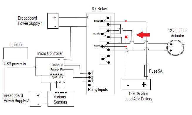

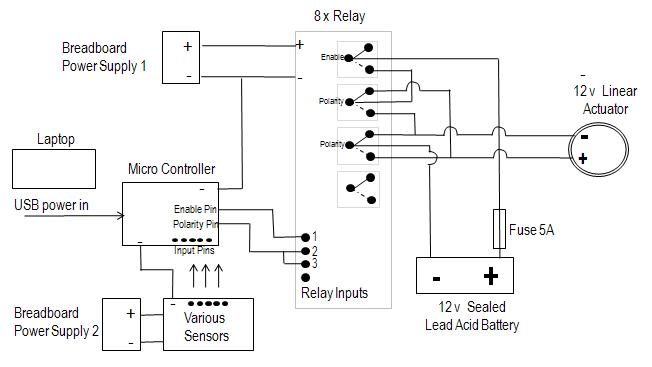

Hi, here it is. This is a much simplified schematic of a section of a wood routing machine I'm making. The diagram supplied relates to the side feed assembly - there are two actuators, so a total of 6 relays used. Ideally I'd like to be able to activate all 6 at once. I'm disabling the motor then using a delay before switching polarity, then a further delay before enabling again - as a means of protecting against short circuiting. Thanks for your advice re the solid state relays. I'm actually using an L298N controlling two actuators to raise/lower the height of a router tray. I could maybe use another of these for the side feed motors in place of the relay arrangement I have? (my reason for using the relays was to avoid the 2v voltage drop from the L298N) Cheers.
Hi Leo, Have posted the diagram, see accompanying text for more info. I tried another adapter which I've tested at 9v output. Same problem persists. I'm thinking I will get a good quality bench power supply. Let me know your suggestions re snubber circuit on the motor side. Cheers. Paul.

Try this:`

Hi, yes the 12volt wiring is entirely separate from the rest of the circuitry and doesn't run alongside any of the sensor wiring. I'm wondering if maybe some RF interference from sparking relay contact could be to blame. Will try connecting diode as advised by @ruilviana and also it seems I have some power supply issues to address. Will post pictures soon. Cheers.

Many thanks @ruilviana I will try what you suggest and also address the power supply issue. Is there a particular diode spec/value I should use?
