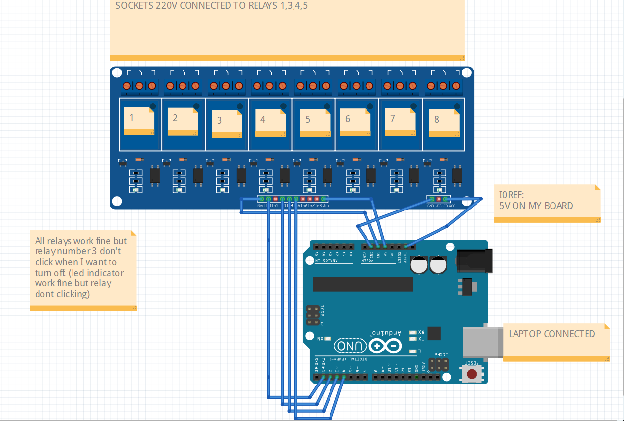

Relay not clicking
Hello, all was explained on photo:
here is code:

Welcome to the forum
Don't use pins 0 and 1 for the relays. These pins are used by the Serial interface
Uno cannot power 8 relays. Each relay will need approximately 80mA, which is a total of 640mA if all 8 relays are energised at the same time. Uno can power 3, maybe 4 relays at the same time. You need an external power supply. 5V, 1A PSU can power all 8 relays and the Uno at the same time.
What was the load that you tried to turn on/off with relay 3?
These relays are not of good quality. Large and inductive loads may weld the contacts together... after that the relay will not click anymore...
Hint: Not all relays make a clicking sound every time. Verify whether the contacts are actually opening and closing as you control them.
That block could result in a short relay activation (all eight) during bootup. It's better for active LOW relay boards with opto couplers to first activate pull up for that reason.
Here pinMode is preferred over digitalWrite.
for (int i = 0; i < 8; i++) pinMode(relayPins[i], INPUT_PULLUP); // first all off (HIGH)
for (int i = 0; i < 8; i++) pinMode(relayPins[i], OUTPUT); // then all output
