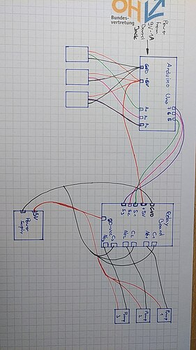

do you have the specs of your 4 relay board ?
what's the current draw when you activate one relay's coil ? (this current will come from your Arduino 5V pin through the regulator which is already quite busy converting ~9V to 5V)
also can you clarify how you connected the pumps to the relay?

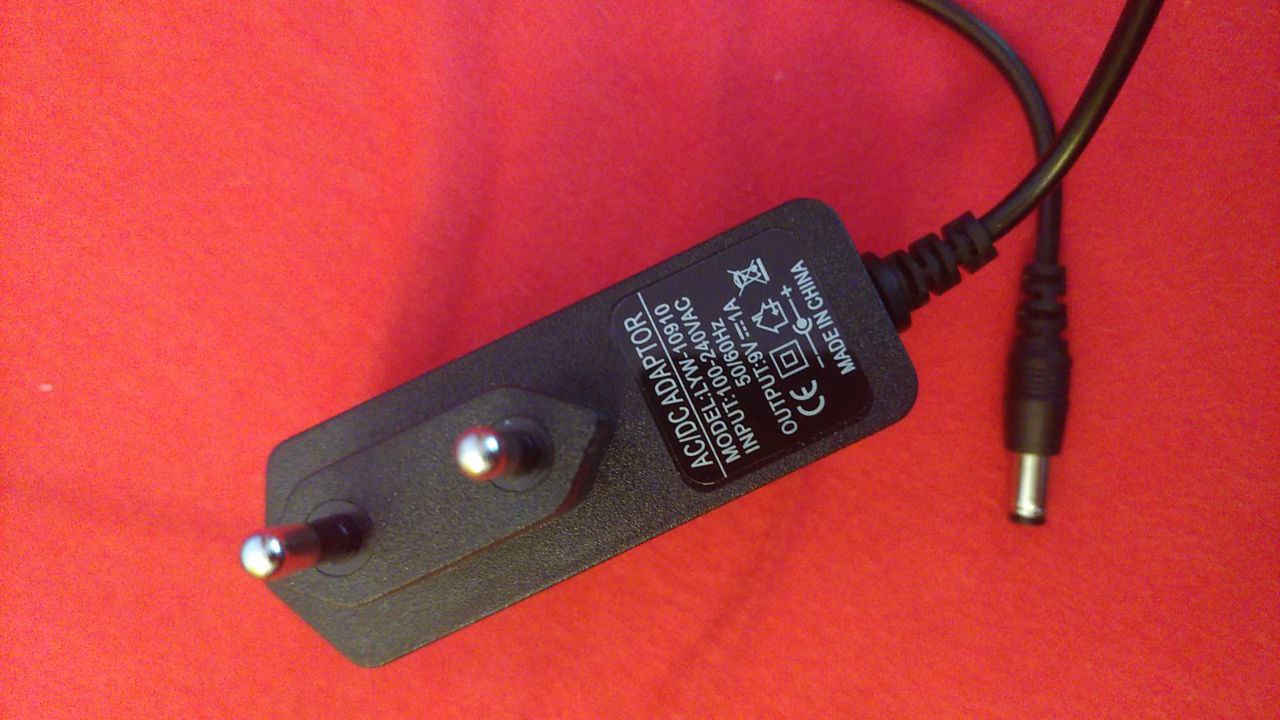

Is this your 9V power supply?

Is the 5V supply well regulated? What are the specifications of the 5V supply? Why not power the Arduino with the 5V supply connected to the 5V and ground of the Arduino?

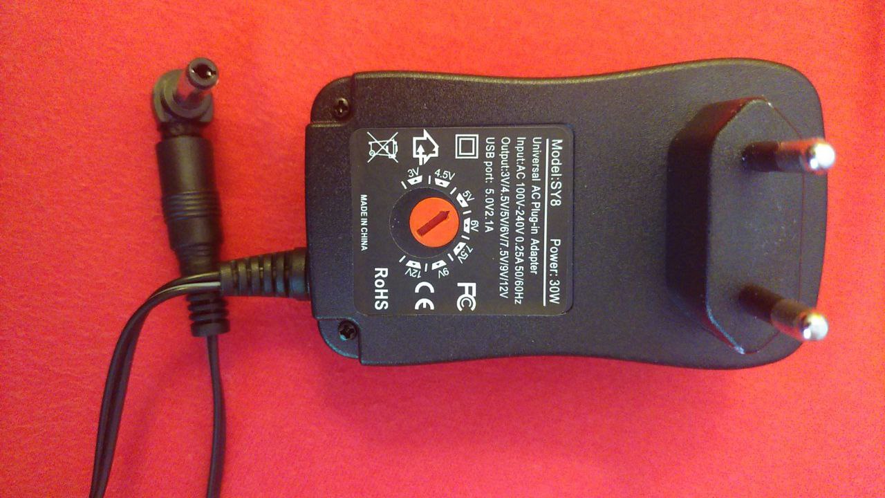

Unfortunately It does not say how much current it is drawing. But I thought I would bypass that problem when using it in the JD Mode ? as the arduino should only provide the signal in that mode and the coil should be powered via the second power supply ?
@groundFungus No I have a normal power Supply you plug in your wall, on the bottom it says 9V 1A
the 5V is just a changeable power supply for the wall. I don't think it regulated well enouth to power the arduino via the Vin pin ??

you have to share the GND between the Arduino and the relay module though
Regulated or not, 5 volt is way under the spec for Vin. Connect it to +5 and make a test,

@J-M-L According to the schematics of the relay model not, as It uses the %v of the arduino and is Low Triggered.
@groundFungus I think the 5V is used to detect the Signal In as The relay Is triggered from Low Level Signals And needs to compare it to the 5V ?

So just connect the second Power Supply to the 5V pin ? Even If I do not know how well regulated those 5V are ? as I read that Those 5V must be from a good power supply?

You are right in being careful with an unknown power supply.

Thank you a lot. I have now tried to use the other power supply 9V-2.1A for the Arduino, but that did not solve the issue. Could It be that even that is to low or Is there any other possible Problem? I think The best solution for now would be to wait more time between samples , as there is no need to sample that often, The project would even work with just one Sample per day. And with a pause of just 1 min the sensor Values should have reset to the valid value. Would just be nice to find out why they behave like this, maybe to know it fore some future projects.

From where do the relays current come? It should not be from the controller 5 volt pin but come from a power supply.
I wish You could sum things up, grab pen and paper and show the powering of the lot by a real schematics. 1 relay is enough to plot as the other ones are connected the same way.

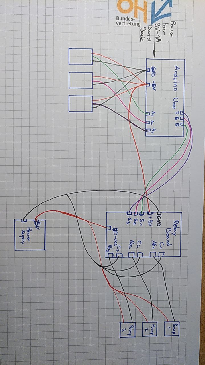

TO SUM UP:
Every time I power something through the relay, the values of the sensors go down. The schematics are still the one from aboth, where the relay is powered from the second Power Supply and not from the arduino board it self. The 5V connection from the arduino board is just needed to detect when the Signals are set to LOW (comparing 5V to LOW from Signal input) . I am sure that it does not use the Arduino power to switch the relay, as it does not switch (make the clicking sound) if the second power supply is turned off. The 3 sensors are powered via the 5V pin of the Arduino. The arduino is powered from a 9V-1A power supply as shown before. But even switching that one for a 9V-2.1A power supply does not make a difference. I have tried another arduino board and another Relay module. The sensor values are only going down, if current is flowing through the relay. if it is switching nothing, the values stay the same.
For your sensor values to drop when the relay actuates, either
  • the relay coil current is in the sensor return(-) path (drawing indicates not)
  • the 5V of the Arduino ADC is sagging due to excess current draw (your evidence says no, as the coil voltage appears to come from the external supply)
  • the sensor output itself is changing, unlikely but possible)
    You sort it out - either your wiring is only approximately the same as the drawing presented, or you have a current path that is loading the Arduino regulator with the coil current, or something is hammering your sensors when the relay actuates.
    I vote for the second one.
