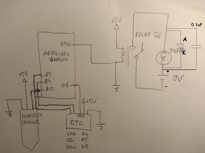

I am trying to build an automatic watering system were I would only check the humidity a few times during the day. For the rest of the time I want to have my arduino in sleep mode to save the battery.
My setup includes arduino nano, RTC, humidity sensor, relay and water pump. Arduino is powered by USB at the moment and pump with 9V DC.
The problem is that whenever I attach the pump to the relay after first operation of the pump arduino will remain in sleep mode and never wake up. This won't happen if there won't be anything attached to the relay.
Anyone have any idea what is wrong here?
Below a photo of my setup and the code.

Schematic?
Hope it's clear
You simplified the relay board, those typically have an optocoupled interface.
SCL & SDA need pullup resistors to 5V, 4.7K is usually used.
CrossRoads:
Yes, fair point. Still they are part of the modules so I didn't find it crucial to include them in the schematics.

As I mentioned in the first post the code works fine without pump attached. Problem starts after first operation of the pump.
Then it could be noise created by the pump or a power supply issue . Where is the 5v supply from that powers the Arduino and is the 9v battery of suitable size ( ie not a little smoke alarm battery ).
hammy:
At the moment I am powering Arduino from the USB connected to my laptop.
Pump is powered from 9V DC adapter. I have also tried different 12V adapter with the same result.
Those motors are in my experience very very noisy electrically.
Have you tried a diode and capacitor across the motor terminals, that is right at the terminals of the motor?
Tom.. :slight_smile:
TomGeorge:
Cheers Tom. I have tried diode but without a capacitor. Will try both and post the result.
TomGeorge:
Adding diode and capacitor improved things slightly. The sleep-wake up-turn on pump cycle will work from 3-4 times. After that Arduino will fall into an infinite sleep.
