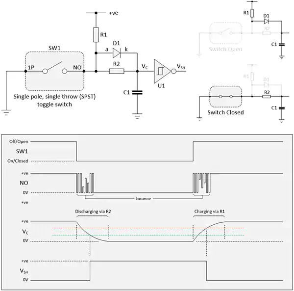

  • In one attempt I build a pretty neat hardware debounce in hardware (resulting in a perfectly smooth curve as checked via an oscilloscope), but which still resulted in ghost counts or double counts.

  • Sample them every 30-50ms looking for a switch change.
  • Add a capacitor (start with 100nF) across the contacts, tune an external pull-up resistor (start with 33k going down.

I've implemented the following from the link above:
I chose the following components:
  • C1: 100 uF
  • R1: 10 kΩ
  • R2: 470 Ω
  • D1: MIC FR107 Rectifier Diode
I'm using a ESP32-WROOM-32D running Tasmota to count the pulses by the reed switch.
I've used a couple of different GPIOs on the board, since I learned from the Espressif's documentation below that some behave different than others:
The good:
  • It reliably counts two impulses per "click" of the rain sensor.
The bad:
  • I get "ghost counts" from time to time.
As mentioned, I already tried using different GPIOs (since I understood that some have a weak pull up or weak pull down included), but no change.
Does anyone have an idea? Maybe using a throttle? If yes, where? Or do I need to implement a filter in addition to the setting above? Are the ghost counts induced by the cable lenght (only ~3 meters)?

Make c1 100nF and R1 much lower, 5k. D1 is likely rectifying noise and producing a DC voltage for your Arduino to register, so leave it out. And no R2.
