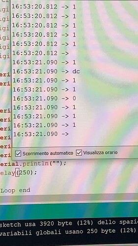

Hi to everyone. I wanted to update you on that idea that I had. I couldn't write you anymore because the machine smashed me lol. Just kidding.
I did something but I got to much busy with work that couldn't go ahead with the project. Now in winter things are more easy and I'm back on charge :grin:
I'm trying to upload some photos of the controller and the receiver that I built.
Shoots! It says I can only upload one photo per message.
First of all I got tempted by all those tutorials on YouTube with personalized pcbs, and after all I thought that it would be a nice solution to withstand vibrations and bumps that the two circuits with be subject to.
So I had to learn that too.
I did some errors, like placing a smaller pin connector on the PCB. So I had to solder wires directly on it, but nothing that couldn't get around.
And after some head banging, I was able to transmit and receive the buttons state from the control to the receiver.
Btw, before I stopped working on it I observed 2 issues: when I closed the control box the wires went near the radio module and disturbed it and it wouldn't send anymore.
And for those who had safety concerns, inspired by a tutorial on drone radio control, I added to the code of the receiver an instruction that brings back to starting state the outputs if radio signal is lost. And that part I already observed that works :sunglasses:
Second issue was. The receiver was activating normally the relay board but when the button was released and the signal went back to normal state the relay remained activated. :man_shrugging:
Another mistake I did was when soldering the radio module to the board and put too much solder and didn't notice and almost fried the Arduino's voltage regulator :sweat_smile:
I have that pair of issues to adjust.
But it was promising. The zeros on the Line was the change of state imposed by the controller and seen on the serial monitor of the receiver.
