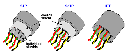

RS485 Cable spec;-
Shielded: Yes
Impedance: 100-130 ohms
Distributed capacitance: <100 pF/m
Wire: AWG 18
Cat 5/6 Cable spec;-
Shielded:STP, ScTP, UTP
Impedance: 85-115 ohms
Distributed capacitance: <= 52 pf/m
Wire: 24–26 AWG/Cat5, 22–24 AWG/Cat6
2 catches for using Cat 5/6 Cable sub RS485 Cable;-
  1. Impedance, It could be fine tune the transceiver resistor to keep match.
  2. Only STP Shielded cable is compatible, order that type cable only.

sonnyyu:
RS485 Cable spec;-
may i ask you why? (just to know it)

take a look picture, UTP is no shield then out. ScTP is shield all pairs then have to out. Only STP Shielded cable is compatible.
transmission line is require impedance match. RS485 transceiver IC is designed to work at Impedance: 100-130 ohms, now we feed it Impedance: 85-115 ohms cable, fine tune resistor to keep match.
all above is for keep system run at long distance, for short distance it does not matter.
but question if for short distance why you use RS485 anyway?
