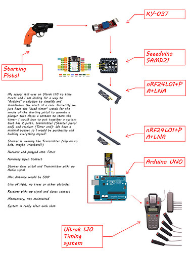

Good afternoon Project Forum, and Happy New Year.
**Backstory -**
I am a Track Coach for a Middle School Team in Michigan and we work with a "Volunteer Army" of parents when they are available to contribute their time. Being volunteers, they have varying skill/interest levels of interest or integrity when they use the "pushbutton triggers" on the Ultrak L10 timing system. I would like to utilize an Arduino and sensors to control the start of the event (starter pistol Bang!). This would free up (1) Volunteer, and everyone can focus on the finish line.
I was originally going down a different path when someone on an engineering forum suggested using an Arduino. I have done some research and had the following ideas for hardware. I am very new to using/setting up anything with Arduino, I grew up with Electromechanical Relaying, so any insight/advice is greatly appreciated
**Concept -**
Attached is a Block Diagram of sorts to help explain what I am trying to accomplish and with what equipment.
**Code -**
None attached. I am totally new to writing any code, from what I have seen online a lot can be copy/paste. This would be my next step after knowing the hardware is correct.
**Questions:**
Remote system (stays with the Starter)
- Is the KY-037 the right sensor to use to capture the starter pistol Bang? I understand that it has a pot to dial down the sensitivity accordingly.
- Is the Seeeduino SAMD21 a good choice for this application? There are so many options, it is rather daunting. Is this unit fast enough to reduce the latency time to a minimum? The timing system measures down to hundredths of a second, I am unsure how much this would add. Repeatability is the main factor...if it reliably adds 6 hundredths of a second, I can factor that out.
Local system (stays with the Ultrak L10)
- The Ultrak L10 uses a Plunger type pushbutton to close a Dry Contact to start the timer. Can the Arduino UNO DO pins be configured as a Dry Contact?
- If not, what else would I have to use to close a contact on the timer?
**Appreciation**
Unlimited to those who are able to help. I am working on zero budget and volunteering my time with this as well as Coaching. I know there are FAT systems and their cost is in the $$$$ range, so it is out of the reach. We have the Ultrak L10 timer paid for so that is what I have to work with.
Track season is a few months away, and this would give me some time to acquire the components, assemble and de-bug on weekend.

Good afternoon Railroader and Happy New Year.
Thanks for the link for the forum. I had started there before I posted as it seemed like the logical choice. It is always difficult to ask general questions to a forum of experienced people, as they are usually light years ahead of beginners. I was trying to avoid something similar to going to your mechanic with the statement "there is a rattle in my car".
Being very inexperienced with Arduino, I had included all of the information that I had access to, essentially just a concept at this point. Essentially a problem, the hardware and a project. I hoped my post would open a dialog with the community for just a few items at first.
1. Does this concept have the potential for working? I searched other Projects and have found nothing similar. The components look like they should meet the build requirements.
2. Has anyone used the components in a similar application? Maybe they have and have found something that is better or more specific to the application.
Thanks again for any information you can help out a beginner with.

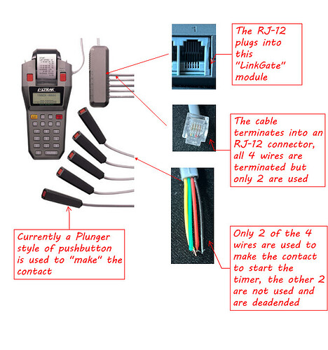

I am unable to find the schematic of the Ultrak L10 Timer or the Link Gate that the Pushbuttons connect to. It must be proprietary information as a service or factory manual. I have attached some photos to show what I do have access to though.
The cable is a 4C and only 2 are used to close a circuit on the pushbutton (I took one apart). Red and Black are used to complete the circuit for the factory set up.
I did poke around with a meter and discovered the following:
Red = +2.6V with respect to Green and Black
Yellow = +2.6V with respect to Green and Black
Red and Yellow show continuity
Green and Black show continuity
Knowing this additional information, could a DO pin be assigned to provide that +2.6V and thus trigger the timer to start?

> [@dccoachpete](#):
Not unless the grounds are also connected! The digital pins only put out almost zero volts or almost the same voltage as the Arduino is using.

So I would have to have the Arduino operate a external relay to "gate" the +2.6V from one wire to the other.
There is no way to directly connect the Arduino to the +2.6v and use it as a relay
<div class="post-metadata">
**Author:** ![Paul\_KD7HB](https://dub1.discourse-cdn.com/arduino/user_avatar/forum.arduino.cc/paul_kd7hb/32/1127958_2.png) [@Paul\_KD7HB](https://forum.arduino.cc/u/Paul_KD7HB)\
**Post date:** [January 1, 2025, 8:27pm UTC](https://forum.arduino.cc/t/remote-timing-for-middle-school-track-using-arduino-and-hardware/1337356/10 "2025-01-01T20:27:16Z")
</div>
> [@dccoachpete](#):
Yes, you could do that, but who would be in charge of moving the system and getting it set up and working each time is was needed?

Good point.
We have an 8 lane track, so there are at least 8 volunteers for timing and 2 scribes for documentation.
The remote system (transmitter) would stay with the starter and his pistol (and KY-037), either at the common start/finish, 100M or 200M start lines. No worries on the distance because of the range of the nRF24L01+PA+LNA
The receiver (Timer) end would stay stationary at the finish line on a table. The Lane Timers are within a few feet of this, watching and ready to push their buttons when the student athletes cross.
With the Arduino components being static, I would expect them to have a reasonable consistency in their timing; KY-037 adjusted to starting pistol signal, transmission wirelessly from/to the NRF24, Arduino "sees" signal and had DO go "high" to operate relay to start timer.
We currently rely on a human to pay attention to the starting pistol and have found them to be inconsistent, sometimes missing the start completely.

It all looks plausible and def possible.
If the only roll of the starter's unit is to send the gunshot signal along to a base station, you could use a radio set that might be easier to get going than the venerable NRF24L01. A fair amount of traffic here is ppl trying to get those working… which eventually they do, but they might have gotten further faster with another choice.
And the little board you've picked is nice, but I would go with one of the regular Arduino boards like the UNO or similar, as working with them is just easier. You might aim for a version zero that does not pretend to sexiness. Version 1 with lessons learned can be compact and whizzy or whatever.
Power the starter's unit with a 2s lipo or LiIon battery and a buck regulator for 5 volts. Those batteries come in a wide variety of sizes and capacities and can easily be designed to last for hours of use.
Treat all batteries with respect, read enough about the chemistry you choose to be expert enough on their care, handling and use including charging.
You can count on needing to experiment. The sound detector should be able to recognize the starter pistol sound, but verify. The putative range of the radio set needs to be confirmed in the real circumstances you intend for deployment.
Don't build the entire system and then try to get it working. You could start with a pushbutton on one Arduino that passes for the signal you want to eventually receive form the remote part and get the base station printing to the serial monitor having purchased nothing but one UNO or similar board.
Get each hardware feature working using example code you didn't write or mess with too much; keep these early sketches handy for trouble shooting when trouble starts making visits.

Good morning alto and Happy New Year!
Thanks for taking a look at my project and giving some feedback.
Can you elaborate on the radio set that you had mentioned instead of the NRF24L01? I am a believer that "simple is best" and appreciate this type of suggestion.
Since size is a factor at the stater end, is there an Arduino equivalent to the Seeeduino that I can use once I verify "proof of concept" with the UNO?

Thanks for the insight on this.
My first problem is a human one. The person who operates the starter pushbutton is inconsistent - Solution Arduino! Automation and Repeatability.
KY-037 would be 3' or less from the starter gun - sound traveling to the sensor should be a non-factor
nRF24 wireless communication delay across 600' with no obstructions- unknown - have to test and verify. I would assume very fast though
Single Channel Relay triggered by Arduino - \<10ms

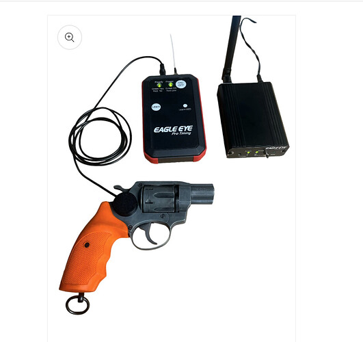

Here is a commercial system example....I can't imagine that there is gold in those black boxes...
 ![image](https://europe1.discourse-cdn.com/arduino/original/4X/b/0/8/b085dc9fdffee405e65274e1a70e6be2470a59ca.jpeg)
....and the price!
 ![image](https://europe1.discourse-cdn.com/arduino/original/4X/8/a/f/8afae0db0c0c28edfbde911f072b6b053aada975.png)
**Includes Wireless Trigger System (as listed below), Power Supply, Belt Clip, 2 x Antenna, 6' USB Trigger Cable, Gun Sensor, Bungie Cord and Hard Sided Carry Case.**
Trigger System
- FCC Extended Range Frequency up to (2miles) line of site
- READY light for Seamless Communication Between Timer & Starter
- Connectivity Light Allows for Single Operator Set Up
- Waterproof Sensor Port
- Rugged Housing
- Can be Used with or without External Gun Sensor
- Flexible Low Profile Transmitter Whip Antenna
- Low Battery Light
- Can be Used with E-Guns such as the Halo.
- Belt Clip
Gun Sensor
- This Optional Gun Sensor Connects to Sensor Port
- Specialized Sensor is Encapsulated within Protective Housing
- Wind, Rain and Touch Proof. Can't be Pre triggered
- Magnetized! -Connect Directly to Your Gun of Choice
- Removed Sensor from Starters Hand!
