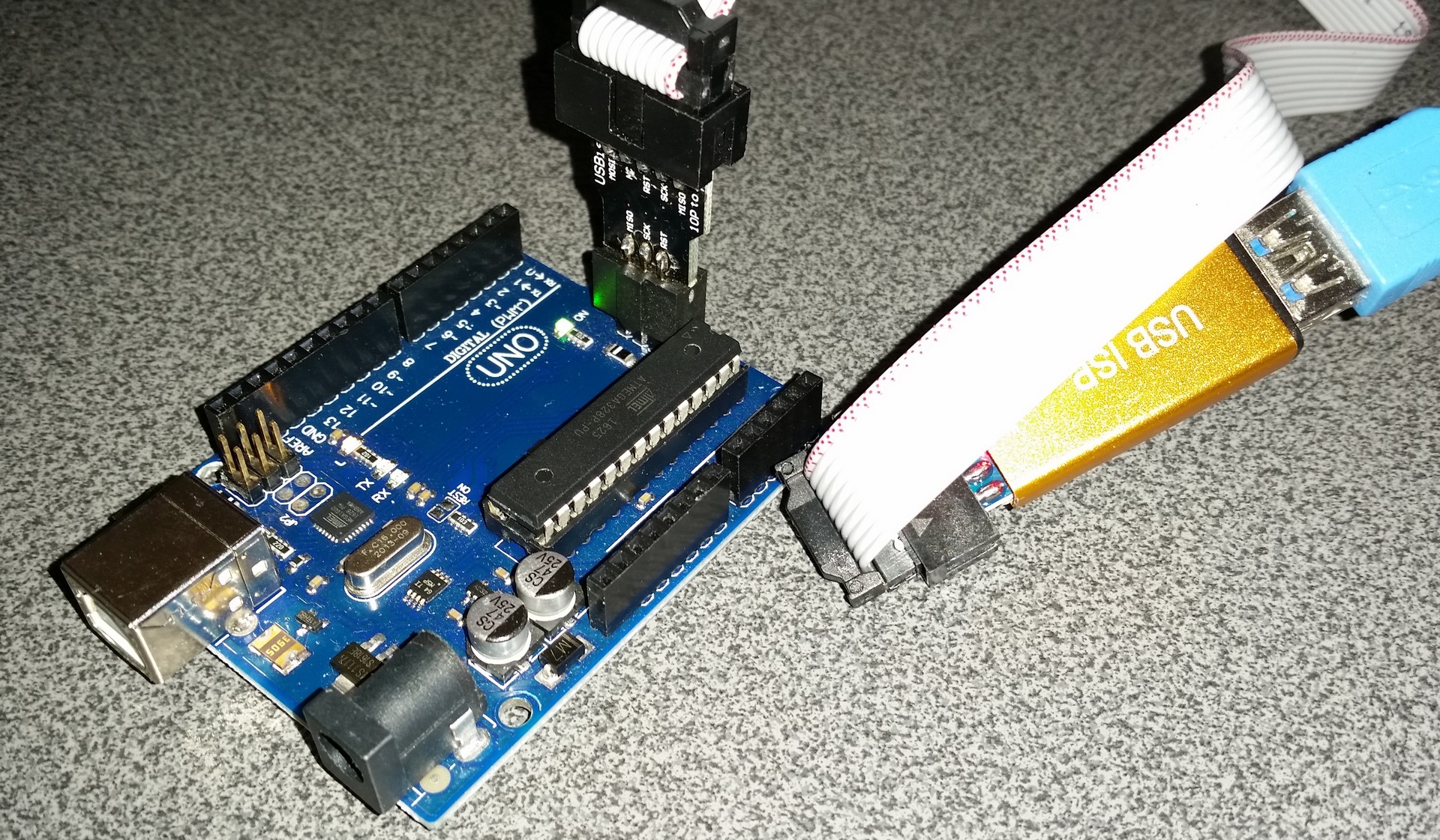

ok i have received my usbisp. and i try to flash the 16u2 chip on arduino uno board with progisp.
But i always have "chip enable program error". My usb is recognized as :
ZF-007 ISP Programmer Ver:1.0 (31/03/2017 15:57:44)
but when i saw that it s not working i have an idea to connecting the usbisp on the another isp connector near the 328p like the picture :
![|500x291](http://shyriu42.free.fr/flash arduino.jpg)
and with the 16u2 selected i flashed and something happens writing verifying ok. But i think i have flash the 328p with 16u2 .hex right ? how it's possible ? and now when i try to burn bootloader in the 328p i always have "chip enable program error".
i'm completly lost. And now ? how can i repare my board ? help me please

I don't have experience with this process or progisp. Is there any more output other than "chip enable program error"? If there is then please post it all as this may help us to figure out the problem.
shyriu42:
That ICSP header is connected to the ATmega328P, the large socketed chip on the board. You can't program the ATmega16U2 via that header. You can use that header with the Arduino IDE functions Tools > Burn Bootloader or Sketch > Upload Using Programmer or also with other flashing tools separate from the Arduino IDE such as avrdude. If you weren't able to get USB uploads working again on your Uno you can still do Upload Using Programmer to load sketches to it, but you won't be able to use the Serial Monitor if the USB circuitry on the board isn't working correctly.
It's possible the ATmega16U2 or another part of the circuitry on the board is permanently damaged, or maybe you just haven't flashed the firmware to the ATmega16U2 correctly.

option enabled in File -> Preferences.
and the famous error.
"avrdude: error: could not find USB device with vid=0x16c0 pid=0x5dc vendor='www.fischl.de' product='USBasp'"
Check out Post #2.
http://rayshobby.net/dead-simple-driver-installation-for-usbasp-and-usbtiny-on-windows/
I’ve used the Zadig program referred to at that link and found it to be very convenient.
forget the usbisp … why can’t do this with another arduino ?
