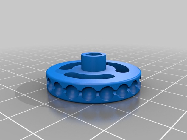

For the chain, it should be able to be shortened; somewhere on the loop of chain should be a crimped "link" - like you would see on a ceiling fan or overhead-light pull-chain. This kind of chain (known as "ball chain" or "beaded chain") is very common, and is used for all kinds of stuff. That crimped link can be easily popped off, the chain shortened (using a pair of wire dikes), then clipped back together. There is, however, one issue with this - which I will get to in a moment.
Once you have the chain shortened, then all you need is some kind of pulley to attach to the gear motor, over which you can run the chain. Fortunately, such things do exist - heck, there's one inside the mechanism of that blind. You might be able to get such a pulley as a "spare part" - either from the blinds manufacturer, or from where you purchased it originally. Alternatively (though more expensively), you could purchase another set of blinds and remove the pulleys. Or - get the end-piece as a spare part.
Sometimes, you can find old blinds and such at a garage sale, tag sale, boot sale - ie, whatever they call such an informal selling in your area; or, check thrift shops and/or "recycled building and remodeling suppliers" if you have them.
You can find such pulleys brand-new - just google around for "ball chain pulley" or similar - you will need to know the pitch of the ball chain - sometimes, though, that can be more expense than it is worth.
Probably the best solution, though, would be the one you already have a tool for - 3D print it! When you google "ball chain pulley" you'll find a ton of links to various 3D models - here's one I found on Thingiverse:
http://www.thingiverse.com/thing:12403
Now I'm not saying that particular model will fit your chain - as noted on that model, it is for 3.5 mm pitch chain - but it looks really similar to standard ball chain. Otherwise, you'll need to find a model that will work for your chain. There seemed like there were more than a few such models out there.
Also note that model is seeming sized for a stepper similar to the one you are already planning to use; that said, make note of bore sizing and what-not - you might need to alter it for your motor (especially if you change over to a gear motor) - this will require modification of the model before printing it.

Just wanted to also mentioned that the pulleys are also called "ball chain sprockets" - so, with that in mind - here's a couple of other items I found:
http://www.thingiverse.com/thing:317721
http://www.thingiverse.com/thing:70179
Also - this one was linked off the one I posted earlier:
http://www.thingiverse.com/thing:3147
It's kinda interesting in that it is a parametric OpenSCAD model - meaning you can alter some variables in the design file, and have it generate different pulleys based on your needs. This might help you fit your particular chain (though I don't know if chain pitch is one of the parameters). It does have various shaft mounting options, which may help with whatever motor you select. I would imagine that pulley size and/or shaft size would be parameters - but I am not sure.
